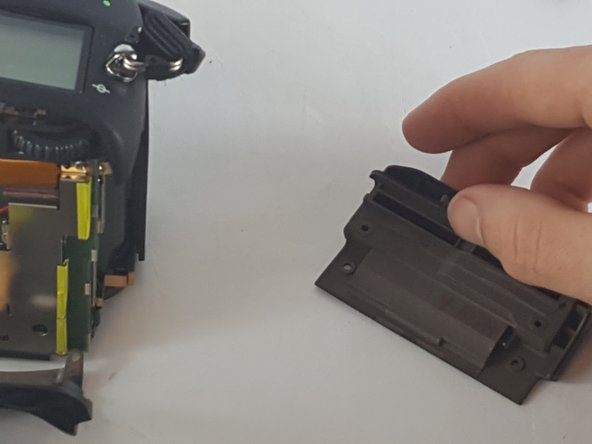

    • It is now possible to remove the last three Philips #00 screws that are hidden under the memory card slot door.
    • The screws come out and the cover comes straight off.

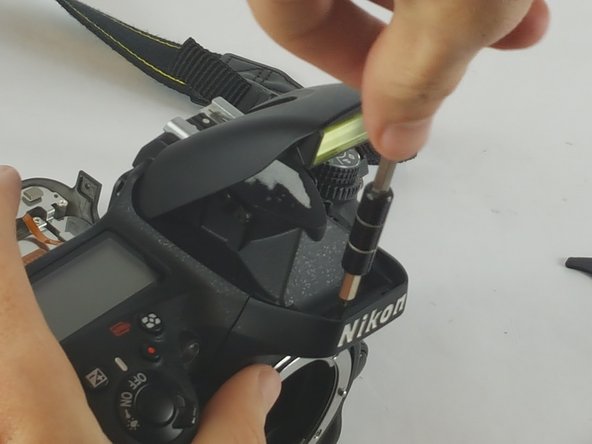

    • The last cover plate is the top. The top is held on by two screws located just beneath the rim of the cover.
    • The top should be pulled off very slowly. There are several electronic components that connect between the body and the top.
    • There are three wires that need to be disconnected.

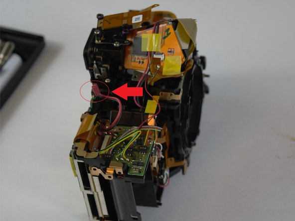

  9. Nikon D610 Flash Capacitor Replacement, Flash Capacitor: crwdns2935265:09crwdnd2935265:01crwdnd2935265:02crwdne2935265:0 Nikon D610 Flash Capacitor Replacement, Flash Capacitor: crwdns2935265:09crwdnd2935265:02crwdnd2935265:02crwdne2935265:0
    • The flash capacitor will be to the right of the lens on the front of the camera.
    • There is only one connection that the flash capacitor makes but this was detached earlier.
    • The pictures shown for the flash capacitor removal is from a complete tear down.
  10. Nikon D610 Flash Capacitor Replacement: crwdns2935265:010crwdnd2935265:01crwdnd2935265:01crwdne2935265:0
    • If your flash capacitor looks damaged you can create a discharge tool with this guide. Constructing a Capacitor Discharge Tool
    • Then use the plastic opening tool to pry from underneath the capacitor from top to bottom in order to remove it.
    • Please note that there is glue holding the capacitor to the frame so it will need some coaxing to get it off.
