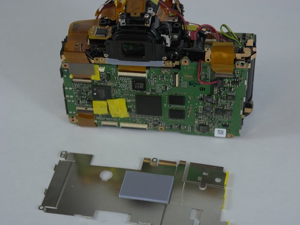

  9. Nikon D610 Autofocus Drive Motor Replacement, Motherboard: crwdns2935265:09crwdnd2935265:01crwdnd2935265:02crwdne2935265:0 Nikon D610 Autofocus Drive Motor Replacement, Motherboard: crwdns2935265:09crwdnd2935265:02crwdnd2935265:02crwdne2935265:0
    • The rear side of the camera is where the motherboard is located. It is visible after you have taken off the rear face plate.
    • Remove the shield that protects it from static first.
    • This shield has six Philips #00 screws that are positioned around the edge of the shield.
    • After removal of the screws the shield will come free from the motherboard.
  10. Nikon D610 Autofocus Drive Motor Replacement: crwdns2935265:010crwdnd2935265:01crwdnd2935265:02crwdne2935265:0 Nikon D610 Autofocus Drive Motor Replacement: crwdns2935265:010crwdnd2935265:02crwdnd2935265:02crwdne2935265:0
    • The six screws that were removed in the previous step also hold the motherboard in place.
    • There are a few ribbon cables that connect to the motherboard to the rest of the camera with some of them hiding under other ribbon cables.
    • Be very careful when removing the ribbon wires. If they break it can cause problems with needing more repairs.

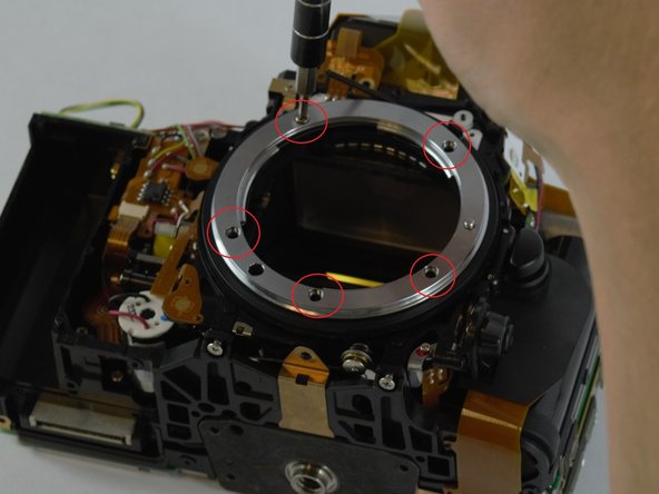

  11. Nikon D610 Autofocus Drive Motor Replacement, Autofocus Drive Motor: crwdns2935265:011crwdnd2935265:01crwdnd2935265:03crwdne2935265:0 Nikon D610 Autofocus Drive Motor Replacement, Autofocus Drive Motor: crwdns2935265:011crwdnd2935265:02crwdnd2935265:03crwdne2935265:0 Nikon D610 Autofocus Drive Motor Replacement, Autofocus Drive Motor: crwdns2935265:011crwdnd2935265:03crwdnd2935265:03crwdne2935265:0
    • The focus motor is located in between the right hand grip and the lens socket and requires several parts to be replaced as a whole because it is unreachable.
    • Begin by removing the silver ring around the lens socket by unscrewing the five screws supporting it.

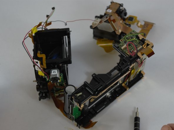

  12. Nikon D610 Autofocus Drive Motor Replacement: crwdns2935265:012crwdnd2935265:01crwdnd2935265:01crwdne2935265:0
    • Several screw and ribbon cables and the bottom portion of the camera need to be removed as shown in the picture

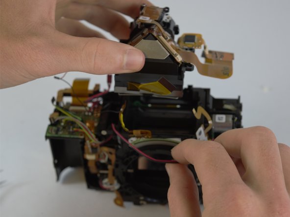

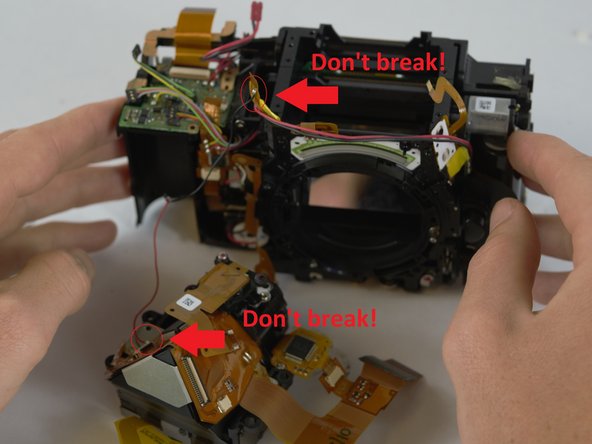

    • Now that the bottom is prepped we move onto the top.
    • Here we have more ribbon cables and screws that need to be removed that will end up releasing the top viewing lens area.
    • Some of the ribbon cables reach back around to the motherboard and may need to be removed there.
    • Also, there is a wire that runs along the top that just needs to be shifted out of the way.
    • be careful not to break the red or black wire attached to some of the ribbon cables as they will need to be re-soldered if broken.

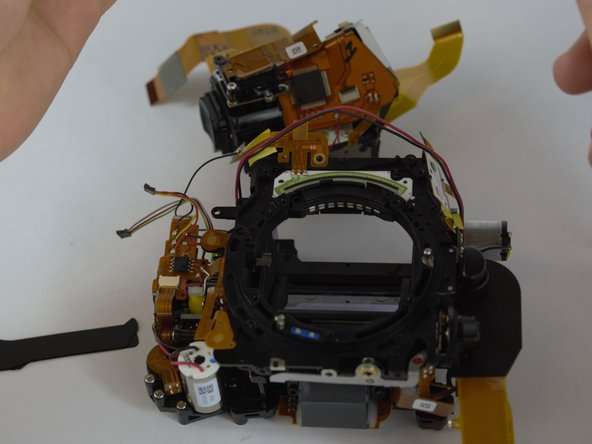

  14. Nikon D610 Autofocus Drive Motor Replacement: crwdns2935265:014crwdnd2935265:01crwdnd2935265:02crwdne2935265:0 Nikon D610 Autofocus Drive Motor Replacement: crwdns2935265:014crwdnd2935265:02crwdnd2935265:02crwdne2935265:0
    • This is where having the motherboard off is necessary as the screws we need are burrowed at the very heart of the camera.
    • Four more screws and two ribbon cables marked by the red circles need to be removed to release what we need.
    • The blue circles indicate the screws that don't need to be undone to get to what we need.
