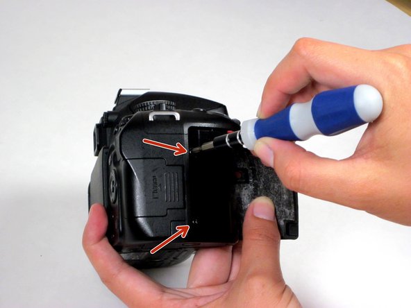

    • Carefully peel back the black rubber hand grip, which is attached to the chassis with a strong adhesive.
    • Use the Phillips #00 to remove two screws beneath the handgrip.

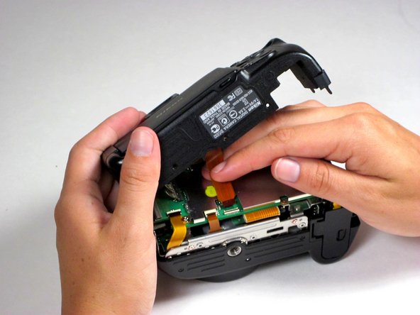

    • Carefully separate the rear panel from the camera body.
    • You will notice some resistance because the two pieces of the camera fit together tightly.
    • Be careful not to damage the chassis or ribbon cables. Use a firm grip to pull the two halves apart.

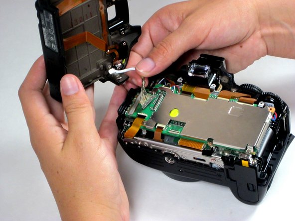

    • Remove the dark orange ribbon cable attaching the rear panel to the motherboard by flipping the black plastic clasp up, away from the motherboard, and pull the cable out of its white casing in the direction of the cable.
    • Using the flat edge of a spudger can help with this delicate task.
  7. Nikon D5100 Motherboard Replacement: crwdns2935265:07crwdnd2935265:01crwdnd2935265:02crwdne2935265:0 Nikon D5100 Motherboard Replacement: crwdns2935265:07crwdnd2935265:02crwdnd2935265:02crwdne2935265:0
    • Remove the silver 16-pin cable by pulling gently upwards, away from the inside of the camera, until it separates from its port.
    • At this point, the rear panel is fully separated from the main body of the camera.

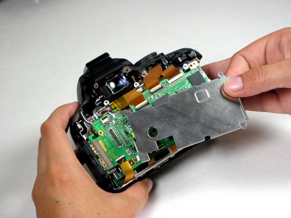

    • Use a Phillips #00 screwdriver to remove the five screws holding the motherboard cover plate. Starting with the right side, lift the plate and remove it from the camera body. Set the plate aside.

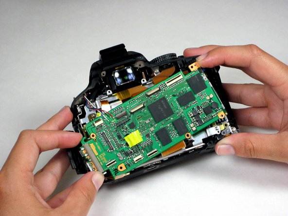

    • Flip the motherboard out of the camera's body, toward the bottom of the device, to expose its underside.
    • Using a spudger, peel back the adhesive, that is protecting the large ribbon cable on the underside of the motherboard.
    • Disconnect the ribbon cable by flipping its clasp up and removing it from the plastic casing in the direction of the cable.
  13. Nikon D5100 Motherboard Replacement: crwdns2935265:013crwdnd2935265:01crwdnd2935265:01crwdne2935265:0
    • The motherboard is now free of all connections to the camera. Remove it from the camera body.
