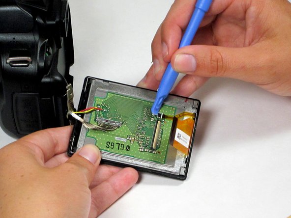

    • Use a Phillips #000 screwdriver to remove the four screws around the perimeter of the LCD panel.
  2. Nikon D5100 LCD Replacement: crwdns2935265:02crwdnd2935265:01crwdnd2935265:01crwdne2935265:0
    • Using a fingernail or the flat edge of a spudger inserted into the seam, separate the LCD bevel from the main panel body.
  3. Nikon D5100 LCD Replacement: crwdns2935265:03crwdnd2935265:01crwdnd2935265:02crwdne2935265:0 Nikon D5100 LCD Replacement: crwdns2935265:03crwdnd2935265:02crwdnd2935265:02crwdne2935265:0
    • Use a spudger to remove the ribbon cables on the LCD's circuit board by flipping up their plastic lock-bars and removing gently pulling them out of their ports.
  4. Nikon D5100 LCD Replacement: crwdns2935265:04crwdnd2935265:01crwdnd2935265:01crwdne2935265:0
    • Use a spudger to disconnect the 16-pin cable by gently pulling it upward, away from the circuit board, until it is removed from its port.
  5. Nikon D5100 LCD Replacement: crwdns2935265:05crwdnd2935265:01crwdnd2935265:01crwdne2935265:0
    • Desolder the 3 wires (red, yellow, and black) connecting the LCD board to the main camera body.
    • Soldering/desoldering presents potential for device damage and burns. Take all necessary precautions, and always solder/desolder in a well-ventilated workspace.
  6. Nikon D5100 LCD Replacement: crwdns2935265:06crwdnd2935265:01crwdnd2935265:02crwdne2935265:0 Nikon D5100 LCD Replacement: crwdns2935265:06crwdnd2935265:02crwdnd2935265:02crwdne2935265:0
    • The LCD assembly can now be fully separated from the main camera body.
    • Remove the plastic bezel and metal bracket from the LCD itself to complete the removal process.

Thank you so much! My camera was dropped . And yelow and black wires came off. Now i will try to fix it.
What is the functions of these wires?
Ilia - crwdns2934203:0crwdne2934203:0
Thanks for this Liz.
Removing the broken LCD from my Nikon D5100 seems like something I can do now!
I am unsure ?how to do the soldering bit to attach the new LCD, ?where to attach the wires...
Any help is welcome
Felipe Castro - crwdns2934203:0crwdne2934203:0
I was able to fix it, thanks to you guys. But the colors that came on the, LCD are weird. At least I can see the image.
Arline Osuna - crwdns2934203:0crwdne2934203:0
It’s very possible that applying the soldering iron to the board, while still attached to the back, caused the LCD to lose its color alignment and darken the display. I made the same mistake.
