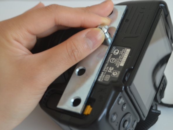

  2. Nikon D5100 Battery Door Replacement: crwdns2935265:02crwdnd2935265:01crwdnd2935265:03crwdne2935265:0 Nikon D5100 Battery Door Replacement: crwdns2935265:02crwdnd2935265:02crwdnd2935265:03crwdne2935265:0 Nikon D5100 Battery Door Replacement: crwdns2935265:02crwdnd2935265:03crwdnd2935265:03crwdne2935265:0
    • Take the mending plate and place it over the threaded hole at the bottom of the camera.
    • Make sure the mending plate is covering the battery compartment.
    • Hold the mending plate in position.

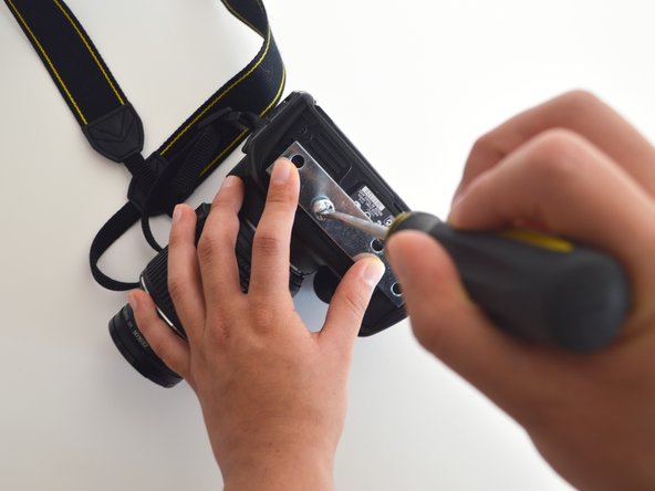

  3. Nikon D5100 Battery Door Replacement: crwdns2935265:03crwdnd2935265:01crwdnd2935265:03crwdne2935265:0 Nikon D5100 Battery Door Replacement: crwdns2935265:03crwdnd2935265:02crwdnd2935265:03crwdne2935265:0 Nikon D5100 Battery Door Replacement: crwdns2935265:03crwdnd2935265:03crwdnd2935265:03crwdne2935265:0
    • While holding down the mending plate, take the screw and place it on top of the mending plate and over the threaded hole.
    • Push the screw into the threaded hole and turn clockwise to screw in.
    • Tighten the screw by using a screwdriver.
  4. Nikon D5100 Battery Door Replacement: crwdns2935265:04crwdnd2935265:01crwdnd2935265:01crwdne2935265:0
    • The metal bar should be attached and tightly secured.
