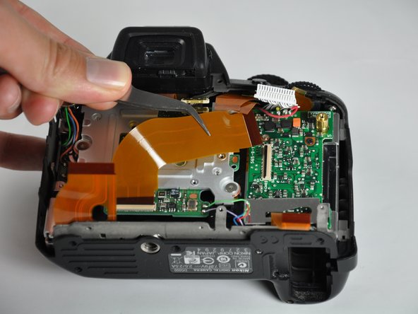

    • Pull the back panel up, then tilt it back. There will be two cables still holding it on.
    • Doing this will also release the connector cover on the left side. Set it aside for now, but remember to reinstall it later.
    • Disconnect the ribbon cable by flipping the black tab up, then pulling the cable out.
    • This procedure also applies to all of the other ribbon cables in the D5000.
    • Pull out the other connector by lifting it up with tweezers, or by prying it out. Fingernails also work well.

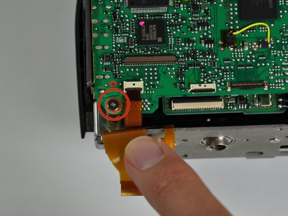

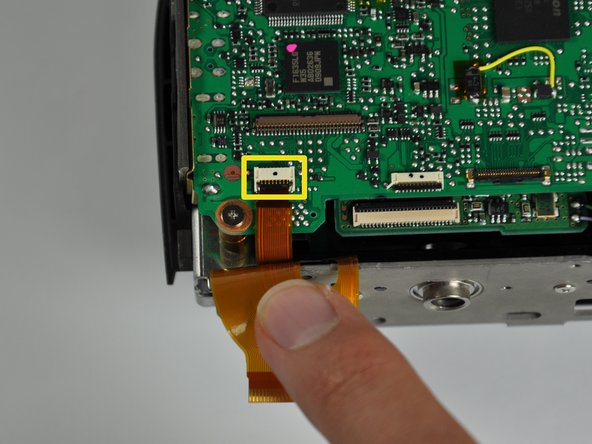

    • Remove the five silver Phillips #00 4x4mm screws.
    • One is hiding under the wide ribbon cable in the lower-right corner.

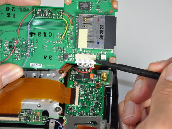

    • Flip up the motherboard.
    • Remove the white cable connector by pulling it out of its socket with a spudger or fingernails.

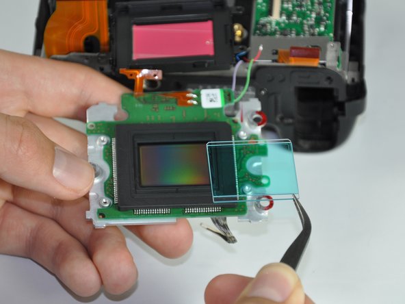

  9. Nikon D5000 Sensor Filter Replacement: crwdns2935265:09crwdnd2935265:01crwdnd2935265:02crwdne2935265:0 Nikon D5000 Sensor Filter Replacement: crwdns2935265:09crwdnd2935265:02crwdnd2935265:02crwdne2935265:0
    • Remove the four silver 3.5x3.5mm screws securing the dust cover.
    • Pull the cover straight up to remove it.
  10. Nikon D5000 Sensor Filter Replacement: crwdns2935265:010crwdnd2935265:01crwdnd2935265:02crwdne2935265:0 Nikon D5000 Sensor Filter Replacement: crwdns2935265:010crwdnd2935265:02crwdnd2935265:02crwdne2935265:0
    • To remove the sensor filter, pull back the rubber gasket to expose the edge. Use a spudger or opening tool to carefully pry out the filter.

Is the dust cover in step 9 just a clear glass or is it also a filter? In the picture, it has a pink tint.
pol techa - crwdns2934203:0crwdne2934203:0 crwdns2950251:0crwdne2950251:0
