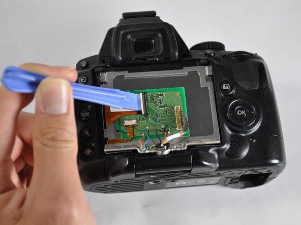

    • Slide the screen assembly forward and off of the hinge mount.
    • With a spudger, opening tool, or fingernail, pop up the clip on the wide ribbon cable.
    • Using tweezers, slide the dark brown portion of the connector down. This will release the lower ribbon cable.
    • Slide both cables out of their connectors.
  5. Nikon D5000 LCD Screen Replacement: crwdns2935265:05crwdnd2935265:01crwdnd2935265:01crwdne2935265:0
    • Pry the circuit board off of the adhesive on the back of the screen. Use a spudger or opening tool.
    • The metal frame is loose at this point. You may want to flip it up and out of the way for this step.
    • The circuit board is flexible, but be careful not to permanently bend or break it!

When I open my D5000 i found out that the Blue and Orange wire on the board was disconnected and had no Idea where it goes (until i saw in the picture then I figured it out). But Overall I managed to assesmble the LCD and was feeling great. Although everytime I change the LCD view upsidedown, it doesnt respond to it unlike putting the view left or right (that works..i wonder why?). Thanks for the guide
http://i.imgur.com/eohsKCp.jpg
http://i.imgur.com/EiC5UI7.jpg
luqmanhakim62 - crwdns2934203:0crwdne2934203:0 crwdns2950251:0crwdne2950251:0
Hi, I also have the blue wire disconnected. Despite this, my screen appears fully functional. Anyone knows what this wire is supposed to do..?
