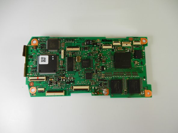

Nikon D40 Mainboard Replacement
The mainboard controls all of the software on the Nikon D40. A faulty mainboard can cause problems that will require a new board. This guide will show you how to replace the camera's mainboard.

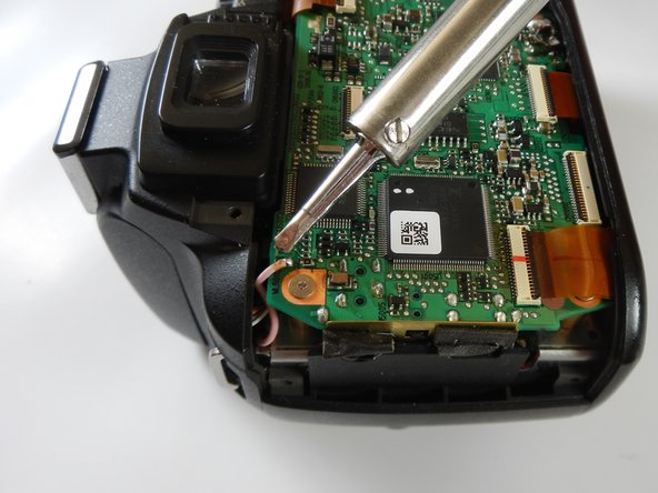

    1. Nikon D40 Mainboard Replacement, Mainboard: crwdns2935265:05crwdnd2935265:01crwdnd2935265:02crwdne2935265:0 Nikon D40 Mainboard Replacement, Mainboard: crwdns2935265:05crwdnd2935265:02crwdnd2935265:02crwdne2935265:0
      • Remove the solder connecting the red wire to the mainboard.
    2. Nikon D40 Mainboard Replacement: crwdns2935265:06crwdnd2935265:01crwdnd2935265:01crwdne2935265:0
      • Desolder the 4 smaller wires near the bottom of the mainboard.

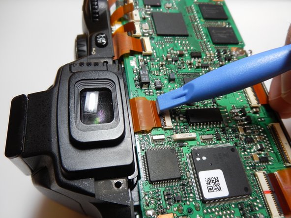

    3. Nikon D40 Mainboard Replacement: crwdns2935265:07crwdnd2935265:01crwdnd2935265:02crwdne2935265:0 Nikon D40 Mainboard Replacement: crwdns2935265:07crwdnd2935265:02crwdnd2935265:02crwdne2935265:0
      • Use the plastic opening tool to release the ribbon cables attached to the mainboard.
    4. Nikon D40 Mainboard Replacement: crwdns2935265:08crwdnd2935265:01crwdnd2935265:01crwdne2935265:0
      • Remove the five 3.0mm Philips #1 screws holding the mainboard down.
    5. Nikon D40 Mainboard Replacement: crwdns2935265:09crwdnd2935265:01crwdnd2935265:02crwdne2935265:0 Nikon D40 Mainboard Replacement: crwdns2935265:09crwdnd2935265:02crwdnd2935265:02crwdne2935265:0
      • Lift the mainboard up to reveal the final connection.
      • Carefully detach the white cable from the board.

What is the ordering of the small wires on the bottom? It is hard to put back together from the photos. Thanks!
