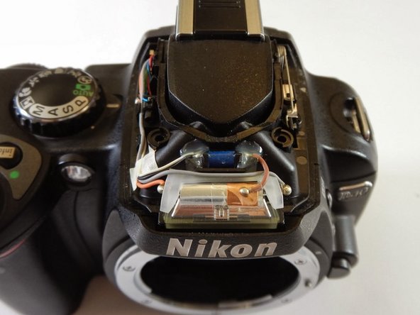

This guide will teach you how to open up your flash safely and replace the flash pin that holds the flash upright.
    1. Nikon D40 Flash Pin Replacement, Flash Pin: crwdns2935265:01crwdnd2935265:01crwdnd2935265:01crwdne2935265:0
      • Turn off the camera and remove the battery.
    2. Nikon D40 Flash Pin Replacement: crwdns2935265:02crwdnd2935265:01crwdnd2935265:01crwdne2935265:0
      • Pry the flash open using the plastic opening tool.
    3. Nikon D40 Flash Pin Replacement: crwdns2935265:03crwdnd2935265:01crwdnd2935265:01crwdne2935265:0
      • Remove the two Phillips #0 3.0 mm screws from the front of the flash compartment using the small Phillips Head screwdriver.
    4. Nikon D40 Flash Pin Replacement: crwdns2935265:04crwdnd2935265:01crwdnd2935265:02crwdne2935265:0 Nikon D40 Flash Pin Replacement: crwdns2935265:04crwdnd2935265:02crwdnd2935265:02crwdne2935265:0
      • Pry off the back plastic of the flash compartment using the plastic opening tool.
      • When it is time to reassemble the flash module, a certain amount of force and precise alignment will be required.
    5. Nikon D40 Flash Pin Replacement: crwdns2935265:05crwdnd2935265:01crwdnd2935265:02crwdne2935265:0 Nikon D40 Flash Pin Replacement: crwdns2935265:05crwdnd2935265:02crwdnd2935265:02crwdne2935265:0
      • On the left of the camera you will see a metal spring.
      • Unscrew the Phillips #0 3.0 mm screw holding the spring in place, using the small Phillips Head screwdriver.
    6. Nikon D40 Flash Pin Replacement: crwdns2935265:06crwdnd2935265:01crwdnd2935265:01crwdne2935265:0
      • Remove metal spring and replace with new spring.
