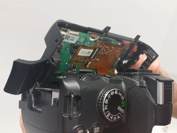

    3. Nikon D3000 On/Off Switch and Shutter Button Replacement: crwdns2935265:03crwdnd2935265:01crwdnd2935265:02crwdne2935265:0 Nikon D3000 On/Off Switch and Shutter Button Replacement: crwdns2935265:03crwdnd2935265:02crwdnd2935265:02crwdne2935265:0
      • Lift the LCD panel off up to expose a ribbon connector. Then lift the ribbon connector tab as shown and slide the ribbon out.
      • Use this technique for all ribbon connectors in this guide.
      • Lift the LCD panel away and off the camera

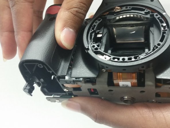

    4. Nikon D3000 On/Off Switch and Shutter Button Replacement: crwdns2935265:04crwdnd2935265:01crwdnd2935265:02crwdne2935265:0 Nikon D3000 On/Off Switch and Shutter Button Replacement: crwdns2935265:04crwdnd2935265:02crwdnd2935265:02crwdne2935265:0
      • Remove six 3 mm x 5.5 mm Phillips head screws from around the lens ring and remove the lens ring.
      • Remove two 2.5 mm x 4 mm Phillips head screws from above the lens ring to allow the front of the camera to be removed.
      • Lift and remove the grip and the front panel of the camera.

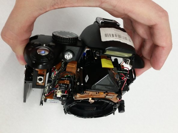

      • Gently lift the top of the camera up to separate it from the main body of the camera. At this point, it will still be connected via wires.
    6. Nikon D3000 On/Off Switch and Shutter Button Replacement: crwdns2935265:06crwdnd2935265:01crwdnd2935265:01crwdne2935265:0
      • Soldering irons are hot. Take all necessary precautions before soldering to prevent damage to the camera or yourself.
      • De-solder the wire shown on the grip side of the camera to allow sufficient access to the top of the camera.

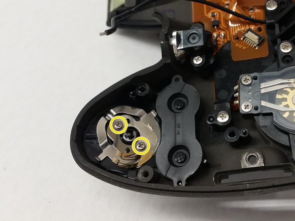

      • Remove the ribbon connector.
      • Remove the 3 mm x 4 mm Phillips head screw and lift off the plastic bracket to expose the on/off switch underneath.
      • A quick inspection should take place before replacing the button and the metal contacts.
      • Remove the two 2 mm x 4 mm Phillips head screws and the shutter button and on/off switch will fall down away from the top of the panel.
