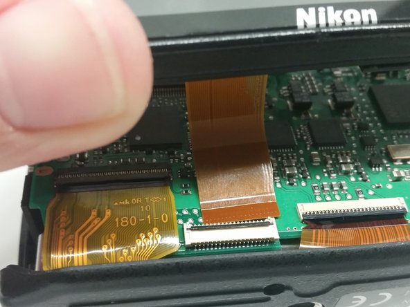

      • Use the following process for removing all ribbon connectors.
      • Lift the back of the camera and, using the blue prying tool, lift the tab from the LCD ribbon connector.
      • Slide the ribbon connector away from the bottom of the camera and remove the back cover containing the LCD to expose the motherboard.
