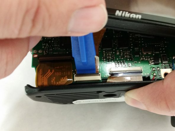

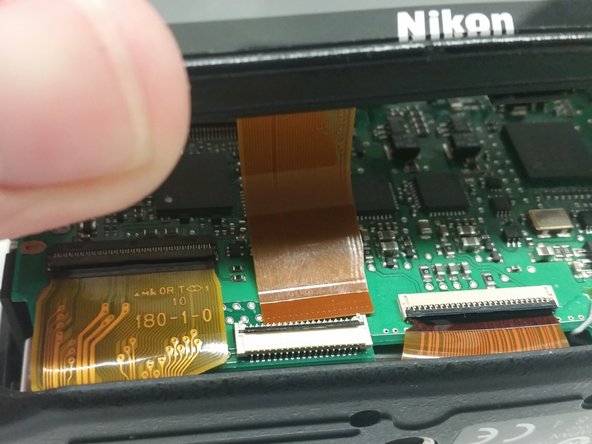

      • Gently lift the back of the camera off, starting with the top first.
      • Lift off the bottom slightly to expose the ribbon connector connecting the back of the LCD screen to the motherboard of the camera and lift the black tab on the ribbon connector.
      • Pull the ribbon away from the connector to disconnect the back panel from the main body of the camera.

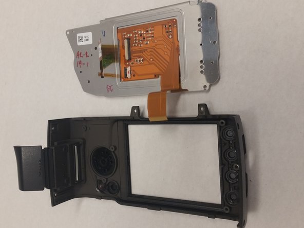

      • Remove six 5 mm x 4mm head screws, then remove the metal plate from the plastic camera backing.
    5. Nikon D3000 LCD Screen Cover Replacement: crwdns2935265:05crwdnd2935265:01crwdnd2935265:01crwdne2935265:0
      • Tape the buttons down on the front of the plastic camera backing in order to avoid losing them in the process.
      • Use a heat gun on the edges of the LCD screen cover in order to loosen the adhesive.
      • Use the prying tool to separate the LCD screen cover from the plastic camera backing (the LCD screen cover will come out towards the front).
      • Install a new LCD screen cover.
