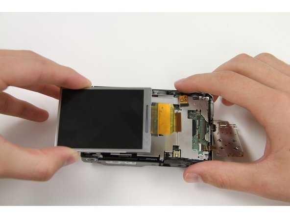

  4. Nikon Coolpix S9050 LCD Screen Replacement: crwdns2935265:04crwdnd2935265:01crwdnd2935265:02crwdne2935265:0 Nikon Coolpix S9050 LCD Screen Replacement: crwdns2935265:04crwdnd2935265:02crwdnd2935265:02crwdne2935265:0
    • Take the blue pry tool and lift the brown latch on the ZIF connecter that holds the screen tab in place.
    • Once the brown latch on the ZIF connecter is lifted upward, carefully lift the screen and pull away from the camera.
    • The screen and screen tab will detach from the motherboard.
  5. Nikon Coolpix S9050 LCD Screen Replacement: crwdns2935265:05crwdnd2935265:01crwdnd2935265:01crwdne2935265:0
    • Take the new screen and slide the tab in to the ZIF connector that the previous screen was plugged in to.
    • Close the brown latch on the ZIF connector and fit the screen in the original slot.
    • Return the dial flap to its original position.
Follow the steps in reverse order to put the camera back together.
