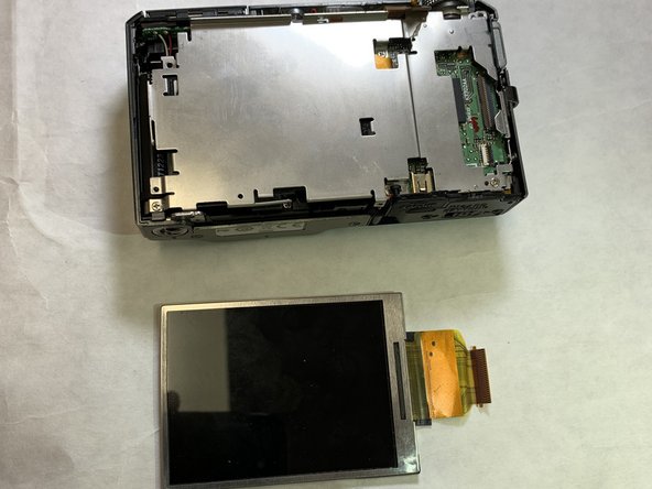

  5. Nikon Coolpix S9050 LCD Screen Replacement, LCD Screen: crwdns2935265:05crwdnd2935265:01crwdnd2935265:01crwdne2935265:0
    • Remove the silver 3.2 mm Phillips #000 screw on the corner of the device to remove the screen.
  6. Nikon Coolpix S9050 LCD Screen Replacement: crwdns2935265:06crwdnd2935265:01crwdnd2935265:02crwdne2935265:0 Nikon Coolpix S9050 LCD Screen Replacement: crwdns2935265:06crwdnd2935265:02crwdnd2935265:02crwdne2935265:0
    • Gently remove pin connector using the spudger to disconnect the screen.
