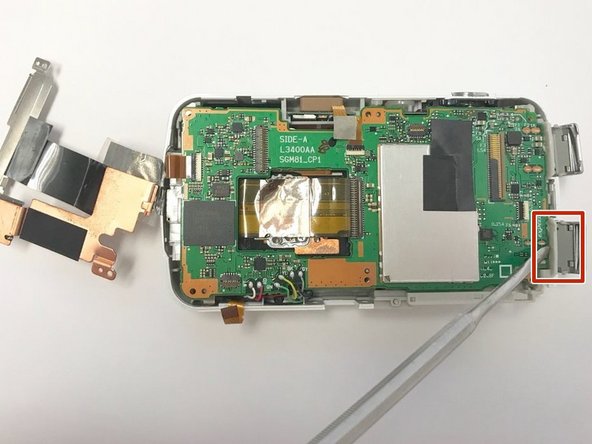

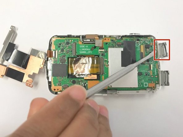

  6. Nikon Coolpix S800c Zoom Unit/Shutter Replacement Guide: crwdns2935265:06crwdnd2935265:01crwdnd2935265:03crwdne2935265:0 Nikon Coolpix S800c Zoom Unit/Shutter Replacement Guide: crwdns2935265:06crwdnd2935265:02crwdnd2935265:03crwdne2935265:0 Nikon Coolpix S800c Zoom Unit/Shutter Replacement Guide: crwdns2935265:06crwdnd2935265:03crwdnd2935265:03crwdne2935265:0
    • Pull the gray panels back to allow the hidden micro usb and hdmi insert connectors to come free.
    • Use a Metal Spudger to help with the process to get these connectors free from the frame.

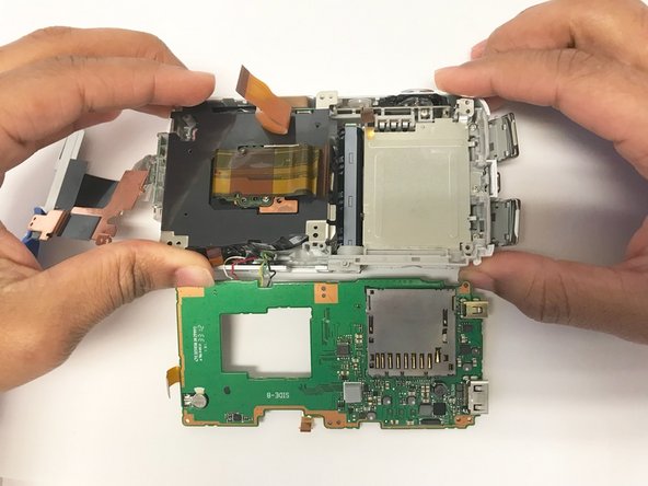

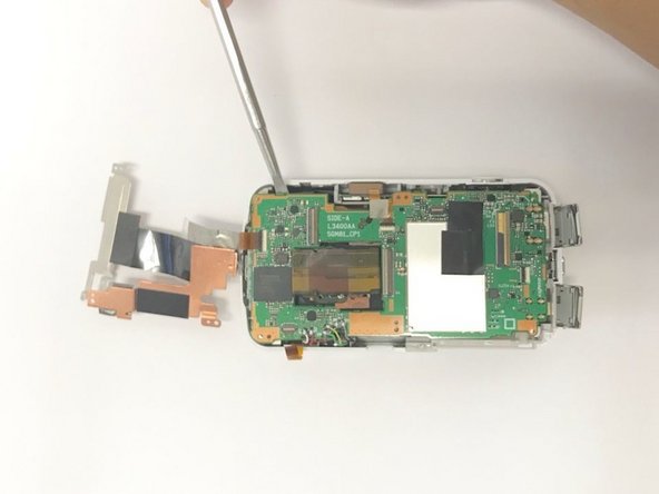

  7. Nikon Coolpix S800c Zoom Unit/Shutter Replacement Guide: crwdns2935265:07crwdnd2935265:01crwdnd2935265:02crwdne2935265:0 Nikon Coolpix S800c Zoom Unit/Shutter Replacement Guide: crwdns2935265:07crwdnd2935265:02crwdnd2935265:02crwdne2935265:0
    • Using a Metal Spudger, lift the motherboard up from the body of the camera.
  8. Nikon Coolpix S800c Zoom Unit/Shutter Replacement Guide: crwdns2935265:08crwdnd2935265:01crwdnd2935265:02crwdne2935265:0 Nikon Coolpix S800c Zoom Unit/Shutter Replacement Guide: crwdns2935265:08crwdnd2935265:02crwdnd2935265:02crwdne2935265:0
    • Pull the motherboard off of the main body of the camera.

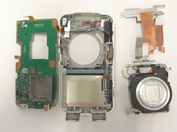

  9. Nikon Coolpix S800c Zoom Unit/Shutter Replacement Guide, Zoom Unit/Shutter: crwdns2935265:09crwdnd2935265:01crwdnd2935265:03crwdne2935265:0 Nikon Coolpix S800c Zoom Unit/Shutter Replacement Guide, Zoom Unit/Shutter: crwdns2935265:09crwdnd2935265:02crwdnd2935265:03crwdne2935265:0 Nikon Coolpix S800c Zoom Unit/Shutter Replacement Guide, Zoom Unit/Shutter: crwdns2935265:09crwdnd2935265:03crwdnd2935265:03crwdne2935265:0
    • Use a plastic opening tool of your choice to loosen and pry up the zoom unit/shutter component.
    • Use your hands to manually lift the zoom unit/shutter component up and out of the main body of the camera.
