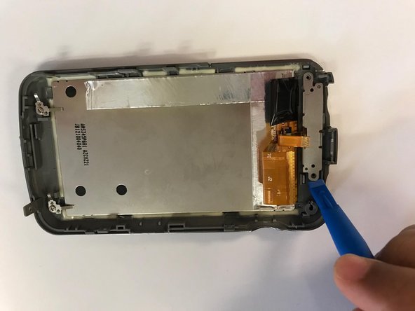

    • Isolate the back panel/touch screen section.
    • Using a Phillips #00 head screwdriver (found in iFixit tool kit), remove the 2 screws that secure the metal plate protecting the selector buttons.
    • Pry the small metal plate up with a plastic tool of your choice.

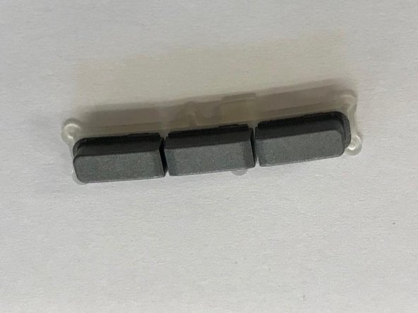

  4. Nikon Coolpix S800c Selector Button  Replacement Guide: crwdns2935265:04crwdnd2935265:01crwdnd2935265:02crwdne2935265:0 Nikon Coolpix S800c Selector Button  Replacement Guide: crwdns2935265:04crwdnd2935265:02crwdnd2935265:02crwdne2935265:0
    • Remove the selector button chain by prying it up with plastic tool of your choice.
