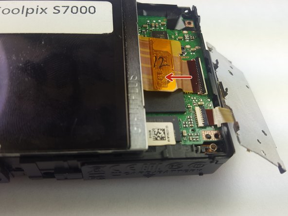

  11. Nikon Coolpix S7000 LCD Display Replacement: crwdns2935265:011crwdnd2935265:01crwdnd2935265:02crwdne2935265:0 Nikon Coolpix S7000 LCD Display Replacement: crwdns2935265:011crwdnd2935265:02crwdnd2935265:02crwdne2935265:0
    • In order to disconnect the LCD display ribbon from the zero insertion force (ZIF) connector we must first flip up the little black tab with your fingernail.
    • Gently pull the out the LCD display ribbon from the connector. It should slide out pretty easy.
    • For this step, avoid using a metal object. However, you can use a finger nail to complete task.

Hello,
thank you for this helpful instrucions. It was easy to follow, however in Step 11 when I tried to open the ZIF Connector, the little black tab jumped away and now I don’t know how to get it back in position. I tried nearly everything but even with precision tweezers I couldn’t fix it. Do you know any help.
By the way, is the Display only working, when the display ribbon is fixed properly with the ZIF connector?
Thank you very much.
Greetings
wasi
