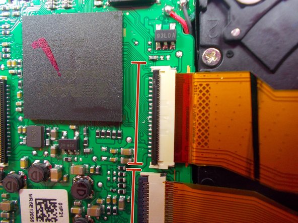

  9. Nikon Coolpix S6800 Display Replacement, Display: crwdns2935265:09crwdnd2935265:01crwdnd2935265:02crwdne2935265:0 Nikon Coolpix S6800 Display Replacement, Display: crwdns2935265:09crwdnd2935265:02crwdnd2935265:02crwdne2935265:0
    • Flip up the little black tab on the connecter of the display's ribbon.
    • Don't use a metal object for this step. A fingernail will do. Simply slide your fingernail under the lip and lift slowly. You may need to lift in different areas along the tab to get it all the way up.
    • The top tab in the second picture is up while the bottom tab is down to show a comparison.
  10. Nikon Coolpix S6800 Display Replacement: crwdns2935265:010crwdnd2935265:01crwdnd2935265:01crwdne2935265:0
    • Gently pull out the ribbon. It should come out easily, don't force it.
