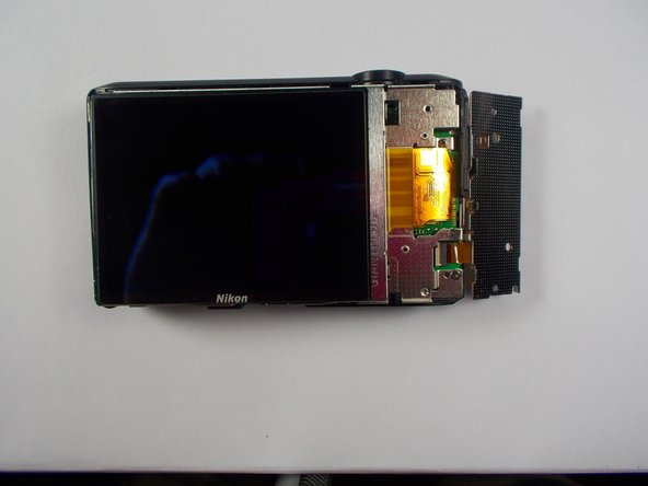

  4. Nikon Coolpix S6800 Button Assembly Replacement: crwdns2935265:04crwdnd2935265:01crwdnd2935265:01crwdne2935265:0
    • Carefully remove the back plate from the body of the camera.
    • All of the external screws are black with rounded heads.
  5. Nikon Coolpix S6800 Button Assembly Replacement: crwdns2935265:05crwdnd2935265:01crwdnd2935265:01crwdne2935265:0
    • Using the Philips #00 Screwdriver, remove the two screws that are holding the keypad.
  6. Nikon Coolpix S6800 Button Assembly Replacement: crwdns2935265:06crwdnd2935265:01crwdnd2935265:02crwdne2935265:0 Nikon Coolpix S6800 Button Assembly Replacement: crwdns2935265:06crwdnd2935265:02crwdnd2935265:02crwdne2935265:0
    • Flip the keypad away from the camera
    • Be careful with the electric ribbon. Do not crease it or tug on it. Gently flip it away from the camera.

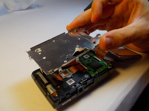

  8. Nikon Coolpix S6800 Button Assembly Replacement: crwdns2935265:08crwdnd2935265:01crwdnd2935265:02crwdne2935265:0 Nikon Coolpix S6800 Button Assembly Replacement: crwdns2935265:08crwdnd2935265:02crwdnd2935265:02crwdne2935265:0
    • Remove the visible midframe screws.
    • There is a screw beneath the foam square that must be removed as well.
    • The screw holding the silver wrist-strap loop on the side of the camera must also be removed.
    • Gently lift the midframe up and out of the device.
    • Be careful moving the midframe away from the ribbons don't force it, gently slide the plate away from the ribbons.

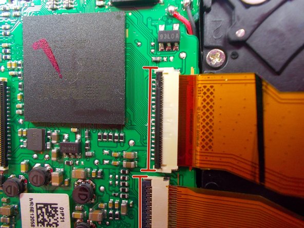

  9. Nikon Coolpix S6800 Button Assembly Replacement, Button Assembly: crwdns2935265:09crwdnd2935265:01crwdnd2935265:02crwdne2935265:0 Nikon Coolpix S6800 Button Assembly Replacement, Button Assembly: crwdns2935265:09crwdnd2935265:02crwdnd2935265:02crwdne2935265:0
    • Flip up the little tan tab on the connecter of the button pad's ribbon.
    • Don't use a metal object for this step. A fingernail will do. Simply slide your fingernail under the lip and lift slowly. You may need to lift in different areas along the tab to get it all the way up.
    • In the second image the top tab is open while the bottom is closed as an example of what the two positions look like.
    • The tab is reversed for the button pad, the tan part is the tab while the black is the connector
