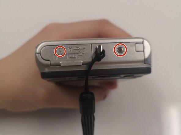

    • Remove all eight 3mm screws by using the Phillips #1 screwdriver. One is behind the flap covering the HDMI and charging ports.

    • Remove the case from the camera.
