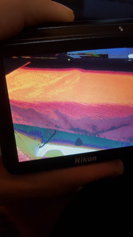

I have this problem with my coolpix (see images and video):
https://i.postimg.cc/pXk2L4QB/20190201-1...
https://i.postimg.cc/d3wYqjLX/20190201-1...
https://i.postimg.cc/RCLmgyYz/20190201-1...
https://drive.google.com/file/d/1sDr8fPD...
Screen has a posterized effect.
I already replaced the screen with a new one, but the problem remains..
Any idea what is faulty, and how can I fix it?
