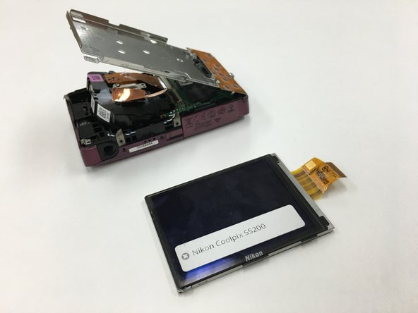

    • There are four 0.1 mm screws holding the front and back of the camera together all along the outside of the camera
    • There should be four screws
  2. Nikon Coolpix S5200 LCD Screen Replacement: crwdns2935265:02crwdnd2935265:01crwdnd2935265:01crwdne2935265:0
    • Use the Phillips Head screw driver head to remove the four 0.1 mm screws surrounding the outer edges of the camera
  3. Nikon Coolpix S5200 LCD Screen Replacement: crwdns2935265:03crwdnd2935265:01crwdnd2935265:01crwdne2935265:0
    • Pull the plastic back cover off of and away from the LCD screen
  4. Nikon Coolpix S5200 LCD Screen Replacement: crwdns2935265:04crwdnd2935265:01crwdnd2935265:01crwdne2935265:0
    • Carefully remove the LCD screen from the silver plate that once held it in place by pulling it away from the internal components
  5. Nikon Coolpix S5200 LCD Screen Replacement: crwdns2935265:05crwdnd2935265:01crwdnd2935265:01crwdne2935265:0
    • Remove the six designated screws sized 0.1 mm from the metal plate using a Phillip's Head screwdriver in size PH00.
  6. Nikon Coolpix S5200 LCD Screen Replacement: crwdns2935265:06crwdnd2935265:01crwdnd2935265:01crwdne2935265:0
    • Lift the metal plate away from the internal components of the camera
  7. Nikon Coolpix S5200 LCD Screen Replacement: crwdns2935265:07crwdnd2935265:01crwdnd2935265:02crwdne2935265:0 Nikon Coolpix S5200 LCD Screen Replacement: crwdns2935265:07crwdnd2935265:02crwdnd2935265:02crwdne2935265:0
    • Carefully remove the LCD screen by pulling it away from the camera. Repeat these steps in reverse order to install the new LCD screen.
