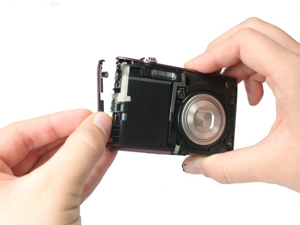

    • Remove the lanyard mount and accompanying side shell casing off of the camera.

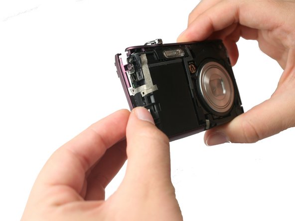

    • Remove the remaining side shell casing.
  11. Nikon Coolpix S4100 Lens Replacement: crwdns2935265:011crwdnd2935265:01crwdnd2935265:01crwdne2935265:0
    • Remove the top shell casing.

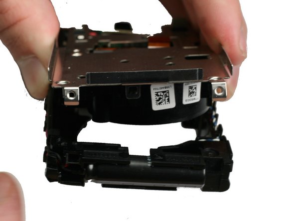

    • Using a plastic spudger, pry open the 4 clamps on the exterior of the screen mount.
    • Separate the screen mount and the lens.

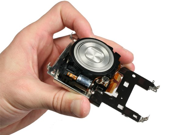

  24. Nikon Coolpix S4100 Lens Replacement: crwdns2935265:024crwdnd2935265:01crwdnd2935265:03crwdne2935265:0 Nikon Coolpix S4100 Lens Replacement: crwdns2935265:024crwdnd2935265:02crwdnd2935265:03crwdne2935265:0 Nikon Coolpix S4100 Lens Replacement: crwdns2935265:024crwdnd2935265:03crwdnd2935265:03crwdne2935265:0
    • Using a plastic spudger, pry the 3 metal clamps away from the lens.
    • The metal clamps are located on the perimeter of the lens.
    • Remove the lens.
