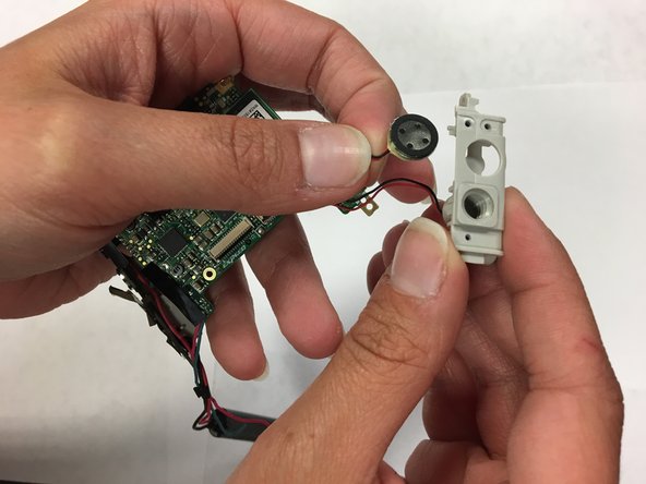

  16. Nikon Coolpix S4000 Speaker Replacement, Speaker: crwdns2935265:016crwdnd2935265:01crwdnd2935265:02crwdne2935265:0 Nikon Coolpix S4000 Speaker Replacement, Speaker: crwdns2935265:016crwdnd2935265:02crwdnd2935265:02crwdne2935265:0
    • Slide the speaker out from the bottom of the speaker piece.
