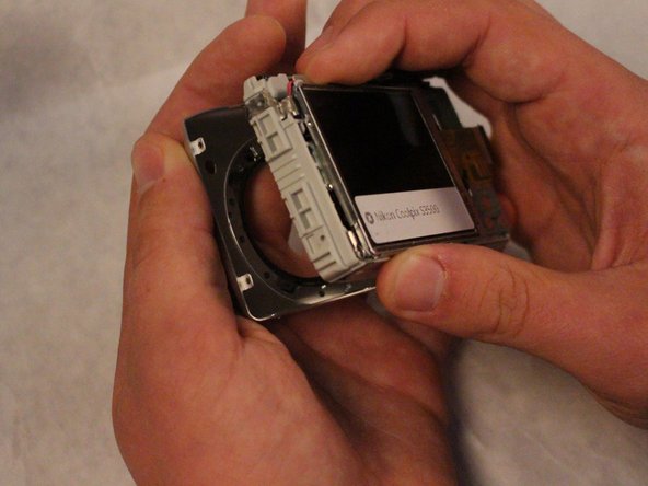

  8. Nikon Coolpix S3500 Shutter Release Button Replacement: crwdns2935265:08crwdnd2935265:01crwdnd2935265:03crwdne2935265:0 Nikon Coolpix S3500 Shutter Release Button Replacement: crwdns2935265:08crwdnd2935265:02crwdnd2935265:03crwdne2935265:0 Nikon Coolpix S3500 Shutter Release Button Replacement: crwdns2935265:08crwdnd2935265:03crwdnd2935265:03crwdne2935265:0
    • Take the thumb of the hand holding the device and place it on the plastic front panel.
    • Make sure to be gentle so no damage is done to any of the inner components of the device.
    • With your free hand, grip the outer edge of the LCD screen and start to pull the LCD from the front panel of the device.
    • This should cause the two pieces to separate from each other.
  9. Nikon Coolpix S3500 Shutter Release Button Replacement: crwdns2935265:09crwdnd2935265:01crwdnd2935265:02crwdne2935265:0 Nikon Coolpix S3500 Shutter Release Button Replacement: crwdns2935265:09crwdnd2935265:02crwdnd2935265:02crwdne2935265:0
    • Now that the 2 pieces are separated, take your free hand and gently press down on the shutter release button.
    • This should cause the shutter release button to come free from the front panel of the device.
