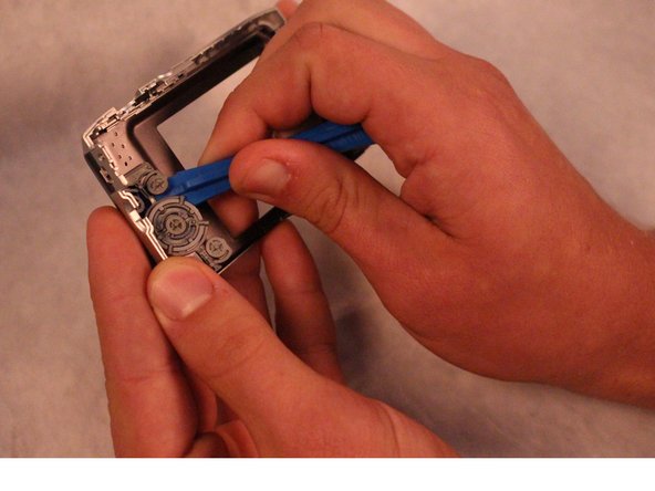

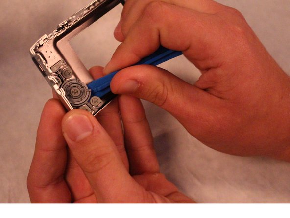

    • On the back side of the device's rear panel, you will see the plastic brackets that hold the rear function buttons in place.
    • With your other hand, take the pry tool and start working your way around the edge of the buttons
  9. Nikon Coolpix S3500 Rear Buttons  Replacement: crwdns2935265:09crwdnd2935265:01crwdnd2935265:02crwdne2935265:0 Nikon Coolpix S3500 Rear Buttons  Replacement: crwdns2935265:09crwdnd2935265:02crwdnd2935265:02crwdne2935265:0

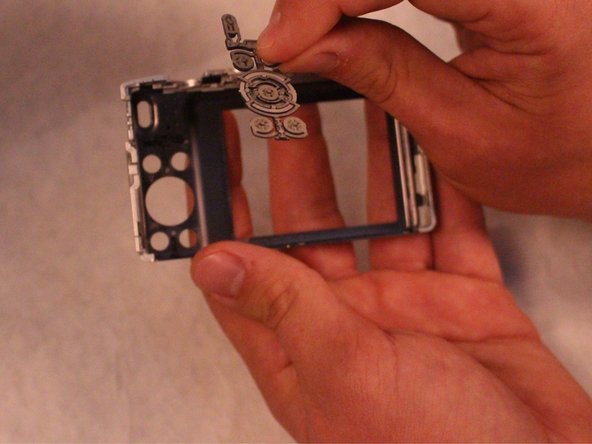

    • Now, take the hand that was previously holding the pry tool, and finish pulling off the rear function buttons.
