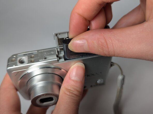

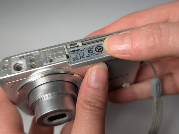

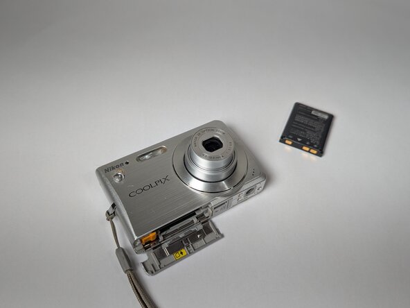

    • Push the power button to activate the camera's power and lens.
    • Rotate the camera so the bottom is facing up and the battery case is facing you.
    • Slide open the battery case, moving it towards the lens.
  2. Nikon Coolpix S200 Lens Replacement: crwdns2935265:02crwdnd2935265:01crwdnd2935265:03crwdne2935265:0 Nikon Coolpix S200 Lens Replacement: crwdns2935265:02crwdnd2935265:02crwdnd2935265:03crwdne2935265:0 Nikon Coolpix S200 Lens Replacement: crwdns2935265:02crwdnd2935265:03crwdnd2935265:03crwdne2935265:0
    • Gently slide the orange tab slightly away from the battery to unlock and release it.
    • Remove the battery with your thumb and index finger, close the cover, and set the battery aside.
    • You have now removed power while having kept the lens "engaged."

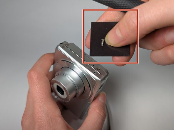

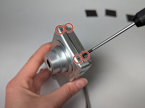

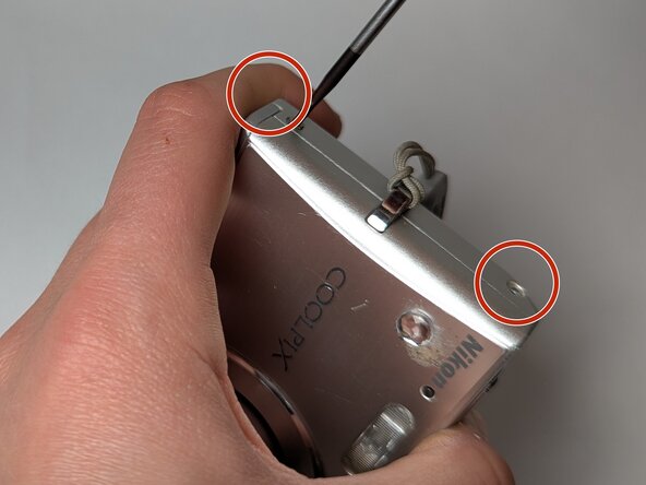

    • With the lens locked, it is time to remove the shell.
    • Remove the 2.8 mm screws located on the bottom and sides of the camera using a Phillips #00 screwdriver.
    • As you work place screws onto magnets to keep track of them
  4. Nikon Coolpix S200 Lens Replacement: crwdns2935265:04crwdnd2935265:01crwdnd2935265:03crwdne2935265:0 Nikon Coolpix S200 Lens Replacement: crwdns2935265:04crwdnd2935265:02crwdnd2935265:03crwdne2935265:0 Nikon Coolpix S200 Lens Replacement: crwdns2935265:04crwdnd2935265:03crwdnd2935265:03crwdne2935265:0

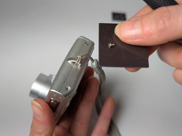

    • Open the battery and memory cover again.
    • Using a Phillips #00 screwdriver, remove the 3 mm screws near the yellow tab.
    • Rotate the camera again to reveal last side of the camera, with the tassel.
    • Remove the 3 mm screws and place them on the magnet strips.

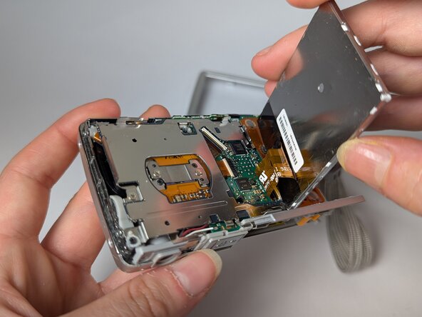

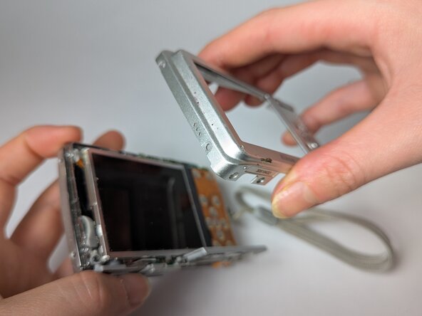

  5. Nikon Coolpix S200 Lens Replacement: crwdns2935265:05crwdnd2935265:01crwdnd2935265:03crwdne2935265:0 Nikon Coolpix S200 Lens Replacement: crwdns2935265:05crwdnd2935265:02crwdnd2935265:03crwdne2935265:0 Nikon Coolpix S200 Lens Replacement: crwdns2935265:05crwdnd2935265:03crwdnd2935265:03crwdne2935265:0
    • The back plastic shell is now loose enough to pull off.
    • Gently lift the shell and place aside.
  6. Nikon Coolpix S200 Lens Replacement: crwdns2935265:06crwdnd2935265:01crwdnd2935265:03crwdne2935265:0 Nikon Coolpix S200 Lens Replacement: crwdns2935265:06crwdnd2935265:02crwdnd2935265:03crwdne2935265:0 Nikon Coolpix S200 Lens Replacement: crwdns2935265:06crwdnd2935265:03crwdnd2935265:03crwdne2935265:0

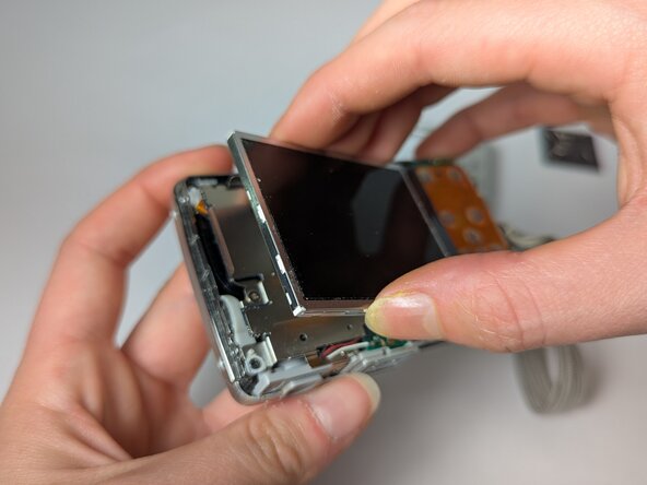

    • Using your fingers, gently lift the screen.
  7. Nikon Coolpix S200 Lens Replacement: crwdns2935265:07crwdnd2935265:01crwdnd2935265:03crwdne2935265:0 Nikon Coolpix S200 Lens Replacement: crwdns2935265:07crwdnd2935265:02crwdnd2935265:03crwdne2935265:0 Nikon Coolpix S200 Lens Replacement: crwdns2935265:07crwdnd2935265:03crwdnd2935265:03crwdne2935265:0
    • Remove two 4 mm screws from the corners and one on the left-hand side.
    • Remove two black 4 mm screws from the center.
    • Remove two silver 3 mm screws from the center.
    • Place loose screws on magnet strips.

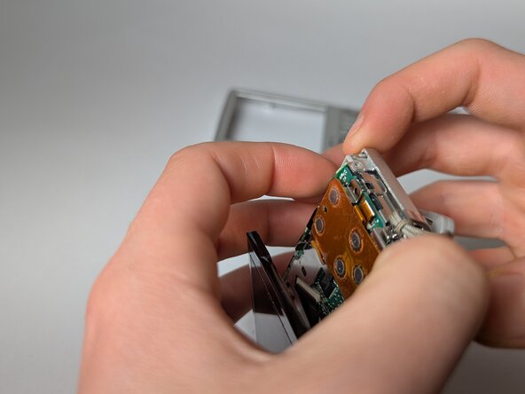

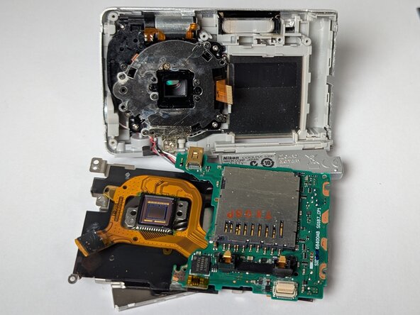

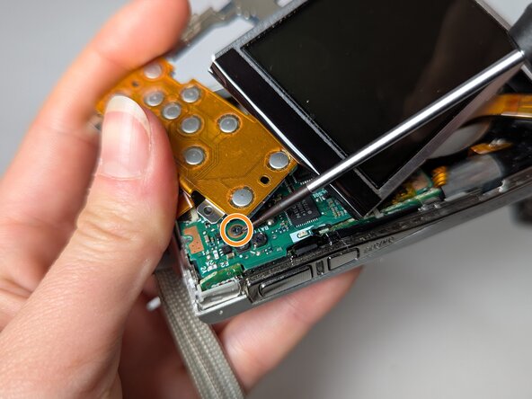

  8. Nikon Coolpix S200 Lens Replacement: crwdns2935265:08crwdnd2935265:01crwdnd2935265:03crwdne2935265:0 Nikon Coolpix S200 Lens Replacement: crwdns2935265:08crwdnd2935265:02crwdnd2935265:03crwdne2935265:0 Nikon Coolpix S200 Lens Replacement: crwdns2935265:08crwdnd2935265:03crwdnd2935265:03crwdne2935265:0
    • Flip the screen back down to work on the orange circuit board.
    • Unscrew the two 3 mm screws.
    • Gently lift the orange circuit board, maintaining all the connected ribbons.
    • Underneath the orange circuit board, remove the 3 mm screw from the green circuit board.

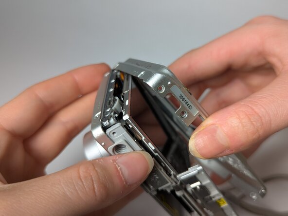

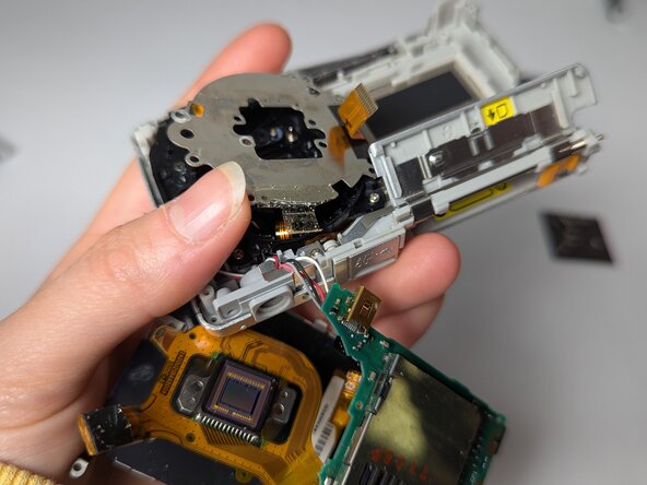

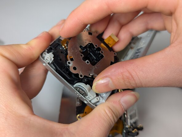

  9. Nikon Coolpix S200 Lens Replacement: crwdns2935265:09crwdnd2935265:01crwdnd2935265:03crwdne2935265:0 Nikon Coolpix S200 Lens Replacement: crwdns2935265:09crwdnd2935265:02crwdnd2935265:03crwdne2935265:0 Nikon Coolpix S200 Lens Replacement: crwdns2935265:09crwdnd2935265:03crwdnd2935265:03crwdne2935265:0

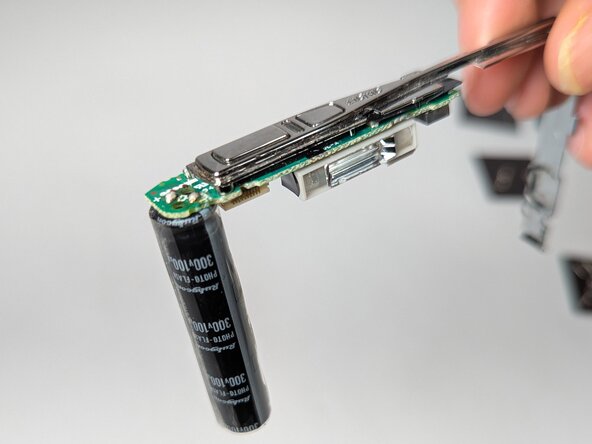

    • When handling the flash there is a risk of electrocution. The black skinny cylinder attached to the top frame of the camera is the charged flash battery. Consider using rubber gloves to prevent minor injury.
    • Using caution and a slightly firm hand, separate the camera into three parts: main body with lens, circuit board with screen, and the flash piece (pictured second).
    • The main ribbon attached to the lens may come undone during the separation process. If it doesn't you must unplug it beforehand, otherwise parts will stay connected.

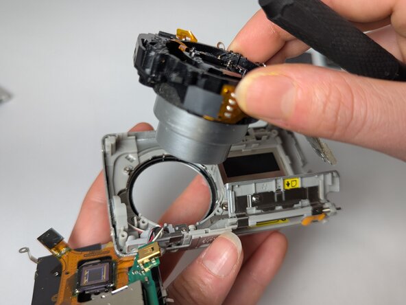

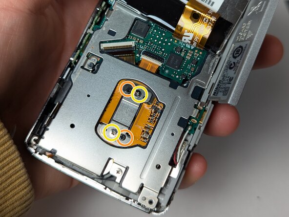

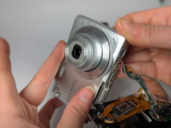

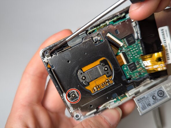

  10. Nikon Coolpix S200 Lens Replacement: crwdns2935265:010crwdnd2935265:01crwdnd2935265:03crwdne2935265:0 Nikon Coolpix S200 Lens Replacement: crwdns2935265:010crwdnd2935265:02crwdnd2935265:03crwdne2935265:0 Nikon Coolpix S200 Lens Replacement: crwdns2935265:010crwdnd2935265:03crwdnd2935265:03crwdne2935265:0
    • Remove all but one black 3 mm screws from the silver lens plate.
    • Lift the lens assembly free.
  11. Nikon Coolpix S200 Lens Replacement: crwdns2935265:011crwdnd2935265:01crwdnd2935265:03crwdne2935265:0 Nikon Coolpix S200 Lens Replacement: crwdns2935265:011crwdnd2935265:02crwdnd2935265:03crwdne2935265:0 Nikon Coolpix S200 Lens Replacement: crwdns2935265:011crwdnd2935265:03crwdnd2935265:03crwdne2935265:0
    • Grab your new lens and all your screws from disassembly.
    • Insert the new lens into the plastic housing where the old lens was.
    • Check the front of the lens to see if it is facing correctly.
    • Reassemble camera!
