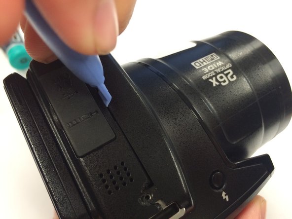

  4. Nikon Coolpix P100 Back Buttons Replacement: crwdns2935265:04crwdnd2935265:01crwdnd2935265:01crwdne2935265:0

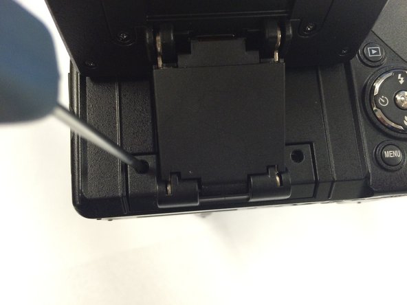

    • Lift the HDMI and A/V OUT cover to access the hidden screw.

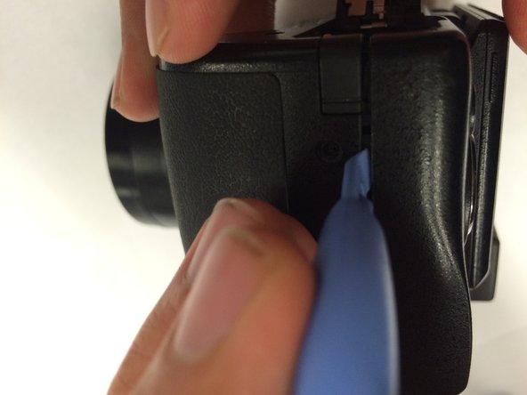

    • Use a plastic opening tool to gently loosen up the sides of the camera.

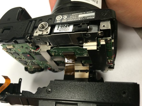

    • Carefully open the camera.
    • There are two ribbon cables when opening the camera. Make sure to properly detach them before proceeding.

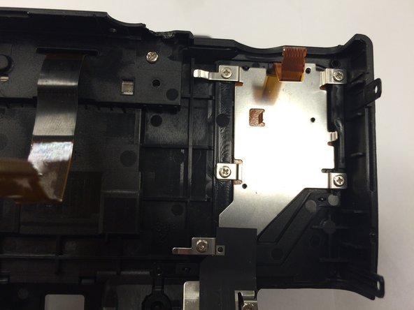

  11. Nikon Coolpix P100 Back Buttons Replacement: crwdns2935265:011crwdnd2935265:01crwdnd2935265:02crwdne2935265:0 Nikon Coolpix P100 Back Buttons Replacement: crwdns2935265:011crwdnd2935265:02crwdnd2935265:02crwdne2935265:0

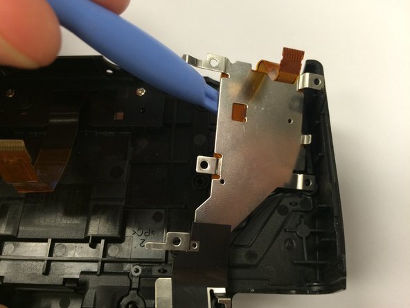

    • Use a plastic opening tool to lift the metal plate and set it aside.

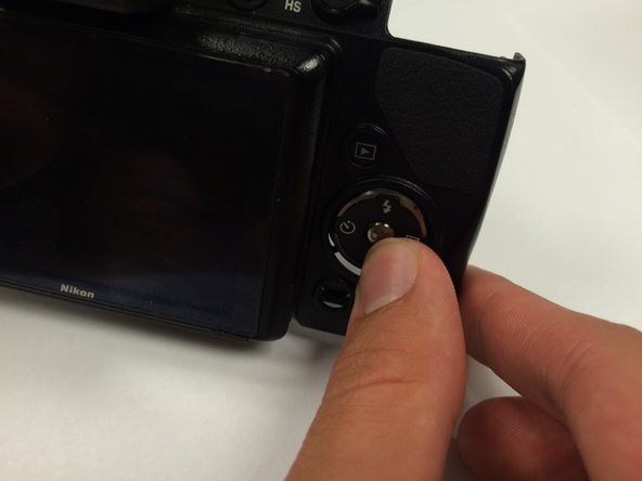

    • Turn the cover around and push against the buttons.

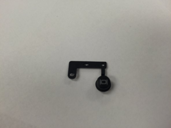

  16. Nikon Coolpix P100 Back Buttons Replacement: crwdns2935265:016crwdnd2935265:01crwdnd2935265:02crwdne2935265:0 Nikon Coolpix P100 Back Buttons Replacement: crwdns2935265:016crwdnd2935265:02crwdnd2935265:02crwdne2935265:0

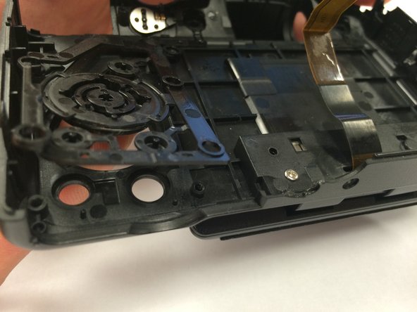

    • Use a plastic opening tool to remove the button.
