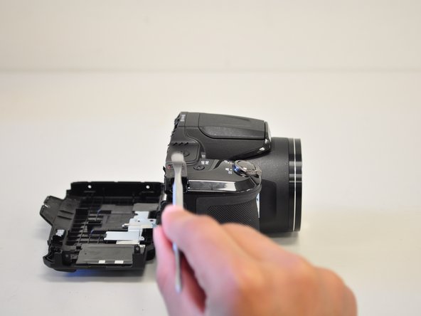

  2. Nikon Coolpix L840 Lanyard Ring Replacement: crwdns2935265:02crwdnd2935265:01crwdnd2935265:01crwdne2935265:0
    • Pry case open with a metal spludger by slipping the spludger between the back and front case of the camera and wiggling the spludger forwards and backwards.
    • Be careful not to damage the inner components of the camera when slipping the spludger into the camera.

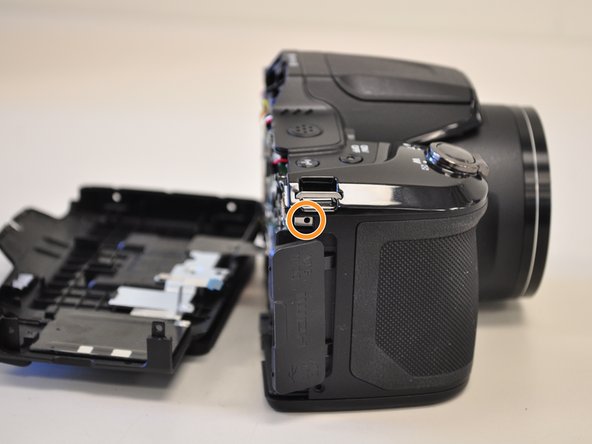

  4. Nikon Coolpix L840 Lanyard Ring Replacement, Lanyard Ring: crwdns2935265:04crwdnd2935265:01crwdnd2935265:02crwdne2935265:0 Nikon Coolpix L840 Lanyard Ring Replacement, Lanyard Ring: crwdns2935265:04crwdnd2935265:02crwdnd2935265:02crwdne2935265:0
    • Identify lanyard ring.
    • Unscrew the 4 mm black screw with a Philips 000.
  5. Nikon Coolpix L840 Lanyard Ring Replacement: crwdns2935265:05crwdnd2935265:01crwdnd2935265:02crwdne2935265:0 Nikon Coolpix L840 Lanyard Ring Replacement: crwdns2935265:05crwdnd2935265:02crwdnd2935265:02crwdne2935265:0
    • Insert a metal spludger (or another sturdy tool with a thin tip) into the hole of the lanyard ring and lift the ring upwards and out of the camera.
