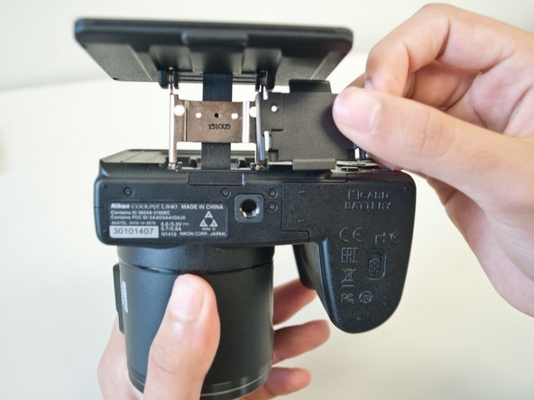

    • Extend the screen by grasping the screen and pulling it out.
  2. Nikon Coolpix L840 LCD Screen Replacement: crwdns2935265:02crwdnd2935265:01crwdnd2935265:01crwdne2935265:0
    • Unscrew the four black, 4mm Phillip #000 screws on the corners of the back case of the screen.
    • Unscrew the two black, 2mm Phillips #000 screws on the case of the hinge. (The hinge connects the screen to the body of the camera.)
  3. Nikon Coolpix L840 LCD Screen Replacement: crwdns2935265:03crwdnd2935265:01crwdnd2935265:02crwdne2935265:0 Nikon Coolpix L840 LCD Screen Replacement: crwdns2935265:03crwdnd2935265:02crwdnd2935265:02crwdne2935265:0
    • Remove the top-half case of the hinge by lifting it off.
    • Remove the bottom-half case of the hinge by lifting it off.
  4. Nikon Coolpix L840 LCD Screen Replacement: crwdns2935265:04crwdnd2935265:01crwdnd2935265:01crwdne2935265:0
    • Pry the back case off of the screen with a metal spludger by slipping the spludger in between the front and back halves of the screen's case and wiggling the spludger forwards and backwards.
  5. Nikon Coolpix L840 LCD Screen Replacement: crwdns2935265:05crwdnd2935265:01crwdnd2935265:01crwdne2935265:0
    • The front cover comes off easily once the back cover is removed in Step 4.
