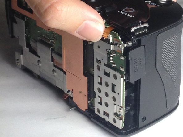

    3. Nikon Coolpix L830 Shutter Button Replacement: crwdns2935265:010crwdnd2935265:01crwdnd2935265:02crwdne2935265:0 Nikon Coolpix L830 Shutter Button Replacement: crwdns2935265:010crwdnd2935265:02crwdnd2935265:02crwdne2935265:0
      • Use your finger to gently pull up the wire ribbon which connects the shutter button to the motherboard.
      • The wire ribbon is located at the top right corner of the motherboard.

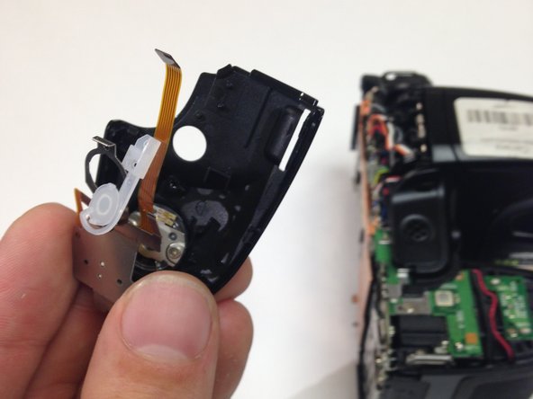

    4. Nikon Coolpix L830 Shutter Button Replacement: crwdns2935265:011crwdnd2935265:01crwdnd2935265:02crwdne2935265:0 Nikon Coolpix L830 Shutter Button Replacement: crwdns2935265:011crwdnd2935265:02crwdnd2935265:02crwdne2935265:0
      • Insert the blue plastic opening tool between the main casing and the shutter component.
      • Wiggle the plastic opening tool up and down to pry off the shutter component.

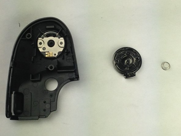

    5. Nikon Coolpix L830 Shutter Button Replacement: crwdns2935265:012crwdnd2935265:01crwdnd2935265:02crwdne2935265:0 Nikon Coolpix L830 Shutter Button Replacement: crwdns2935265:012crwdnd2935265:02crwdnd2935265:02crwdne2935265:0
      • Unscrew the single 2.0mm Phillips #000 screw located on the dark brown strip on the back of the shutter button panel.
      • Once the Phillips screw is removed, gently take off the metal component with your hand or a wedge tool.
      • The on/off switch is not connected to the metal component, so be sure to keep track of it when removing.
      • Once the metal component is removed, the shutter button should be the only remaining part connected to the black shutter casing.
    6. Nikon Coolpix L830 Shutter Button Replacement: crwdns2935265:013crwdnd2935265:01crwdnd2935265:02crwdne2935265:0 Nikon Coolpix L830 Shutter Button Replacement: crwdns2935265:013crwdnd2935265:02crwdnd2935265:02crwdne2935265:0
      • Remove the final two 2.0mm Phillips #000 screws, releasing the shutter button.
      • The shutter component has a spring attached. Be sure to carefully remove the shutter button and keep track of the small spring.
