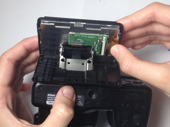

    4. Nikon Coolpix L830 LCD Monitor Replacement: crwdns2935265:04crwdnd2935265:01crwdnd2935265:01crwdne2935265:0
      • Remove the back cover of the LCD monitor with your hands or a plastic opening tool.
      • The cover will slide down the hinge, but it will not be completely removed.
    5. Nikon Coolpix L830 LCD Monitor Replacement: crwdns2935265:05crwdnd2935265:01crwdnd2935265:02crwdne2935265:0 Nikon Coolpix L830 LCD Monitor Replacement: crwdns2935265:05crwdnd2935265:02crwdnd2935265:02crwdne2935265:0
      • Use your thumb to gently pull the small flex ribbon wire connector from its socket.
      • Use your thumb to gently pull the wide flex ribbon wire connector from its socket.
    6. Nikon Coolpix L830 LCD Monitor Replacement: crwdns2935265:06crwdnd2935265:01crwdnd2935265:01crwdne2935265:0
      • Use a plastic opening tool to remove the front cover of the LCD monitor, allowing the monitor to be completely be released.
    7. Nikon Coolpix L830 LCD Monitor Replacement: crwdns2935265:07crwdnd2935265:01crwdnd2935265:01crwdne2935265:0
      • Gently remove the old, damaged LCD monitor.
