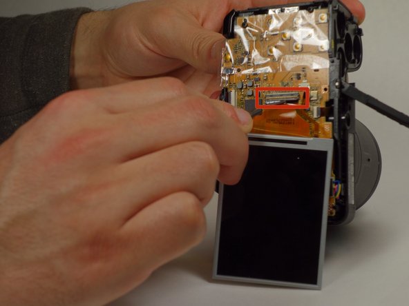

  5. Nikon Coolpix L810 Motherboard Replacement: crwdns2935265:05crwdnd2935265:01crwdnd2935265:02crwdne2935265:0 Nikon Coolpix L810 Motherboard Replacement: crwdns2935265:05crwdnd2935265:02crwdnd2935265:02crwdne2935265:0
    • With the LCD screen facing towards you, flip the screen to the right.
  6. Nikon Coolpix L810 Motherboard Replacement: crwdns2935265:06crwdnd2935265:01crwdnd2935265:03crwdne2935265:0 Nikon Coolpix L810 Motherboard Replacement: crwdns2935265:06crwdnd2935265:02crwdnd2935265:03crwdne2935265:0 Nikon Coolpix L810 Motherboard Replacement: crwdns2935265:06crwdnd2935265:03crwdnd2935265:03crwdne2935265:0
    • Remove three 5 mm Phillips #000 screws located on the bracket.
    • Hold the camera with the lens facing downward to prevent the bracket from falling off once all screws are removed.
  7. Nikon Coolpix L810 Motherboard Replacement: crwdns2935265:07crwdnd2935265:01crwdnd2935265:02crwdne2935265:0 Nikon Coolpix L810 Motherboard Replacement: crwdns2935265:07crwdnd2935265:02crwdnd2935265:02crwdne2935265:0
    • Disconnect the ribbons that connect the LCD screen to the camera gently using precision tweezers or fingers.

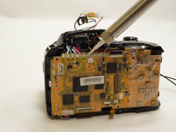

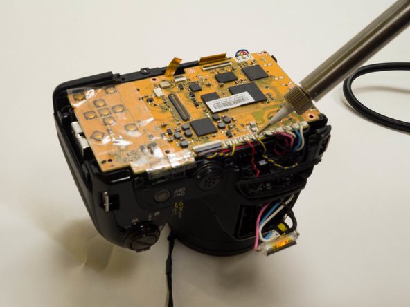

  11. Nikon Coolpix L810 Motherboard Replacement: crwdns2935265:011crwdnd2935265:01crwdnd2935265:03crwdne2935265:0 Nikon Coolpix L810 Motherboard Replacement: crwdns2935265:011crwdnd2935265:02crwdnd2935265:03crwdne2935265:0 Nikon Coolpix L810 Motherboard Replacement: crwdns2935265:011crwdnd2935265:03crwdnd2935265:03crwdne2935265:0
    • Unsolder all the wires that are on the top of the motherboard near the flash component.
  12. Nikon Coolpix L810 Motherboard Replacement: crwdns2935265:012crwdnd2935265:01crwdnd2935265:01crwdne2935265:0
    • Unsolder the wires on the bottom end of the motherboard.

The guide is incomplete! Do not try to remove the mobo for it is soldered to some other tiny board under the on/off switch. Trying to remove the mobo after just unscrewing it, may guide to certain and permanent destruction of both PCBs!!!
symeonleriou - crwdns2934203:0crwdne2934203:0
any clue how to get tiny mobo out with mobo after taking screw out of tiny one at on/off switch?
jon baker - crwdns2934203:0crwdne2934203:0
This guide should be for beginners, Mr. Symeon Leriou, and you will not only write "Mobo", but also motherboard or Mainboard or Hauptplatine (deutsch)
But I agree with you that it is not complete.
The motherboard is soldered to the on / off board (power supply for the batteries).
Soldering again is almost impossible ...
lothar4460 - crwdns2934203:0crwdne2934203:0
Exactly! The guide is GOOD but it is incomplete!
The solder removal is insufficient to release de motherboard.
How to do it?
