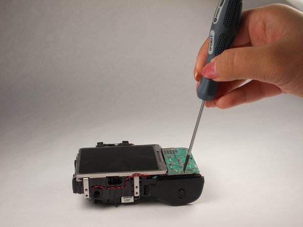

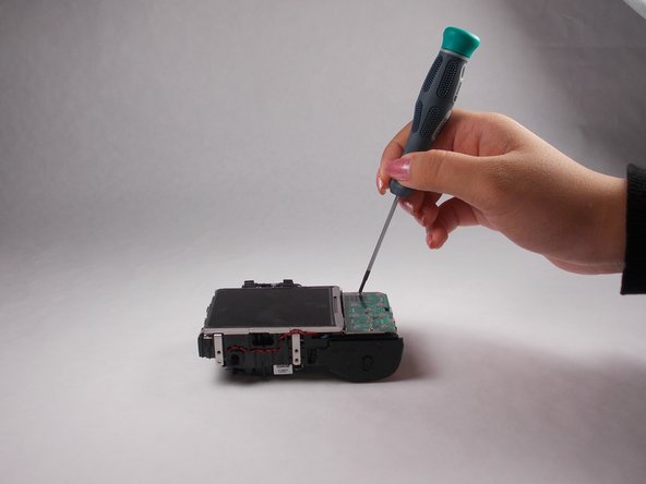

    • Carefully unscrew and remove the top and bottom (2.25 mm) screws from the control panel.
    • Carefully unscrew and remove the middle (3.20 mm) screws from the control panel.

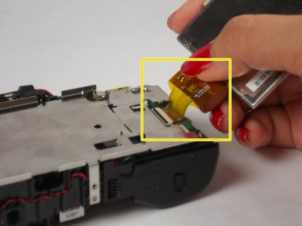

    • While the LCD screen is loose and unattached, there is a latch that is holding the ribbon in place. Slide the latch down and pull the ribbon out.

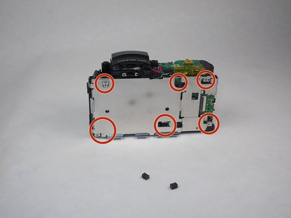

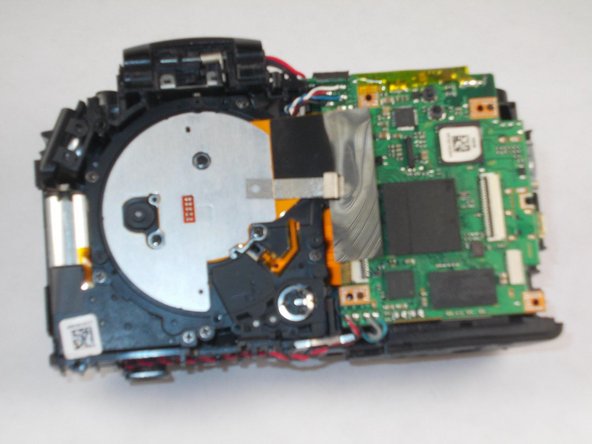

    • Remove the 6 (3.70 mm) screws on the metal cover. Two of those screws are covered by black plastic covers.
    • After removing the screws the panel should come off and will look like the final image.
    • Be careful of the red and black wires on the top. If the flash is charged you could get a mild shock.

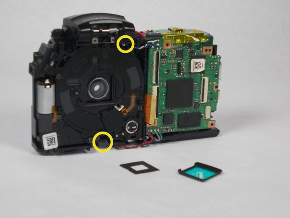

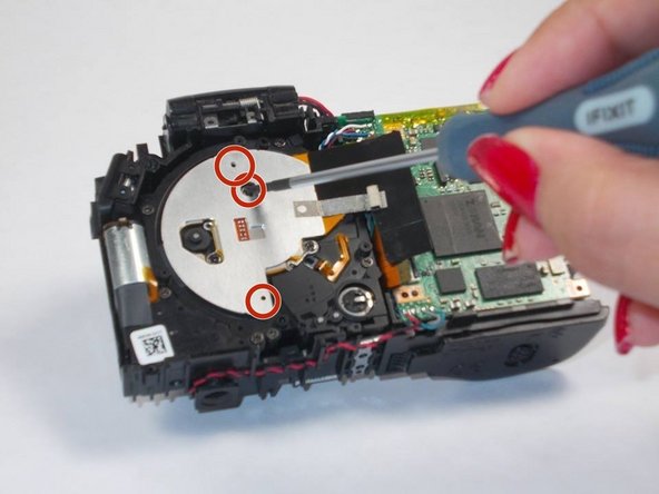

    • Remove the 3 (3.10 mm) screws that are located on the back of the lens cover.
  12. Nikon Coolpix L610 Camera Lens Replacement: crwdns2935265:012crwdnd2935265:01crwdnd2935265:03crwdne2935265:0 Nikon Coolpix L610 Camera Lens Replacement: crwdns2935265:012crwdnd2935265:02crwdnd2935265:03crwdne2935265:0 Nikon Coolpix L610 Camera Lens Replacement: crwdns2935265:012crwdnd2935265:03crwdnd2935265:03crwdne2935265:0

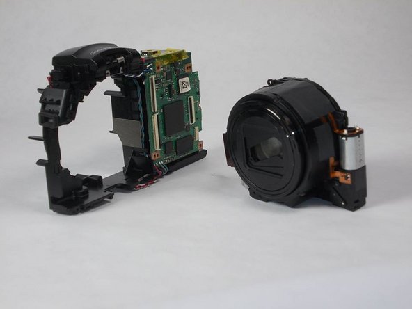

    • There are two lens covers that will fall out after removing the back lens plate.
    • Remove the 6 (4.35 mm) screws surrounding the lens.
    • There are 2 more (3.70 mm) screws covered by a small black square located. Remove the black squares and proceed to unscrewing these final screws.
    • Remove the lens. It should just be free to pull it out.
