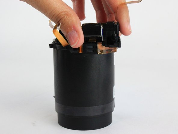

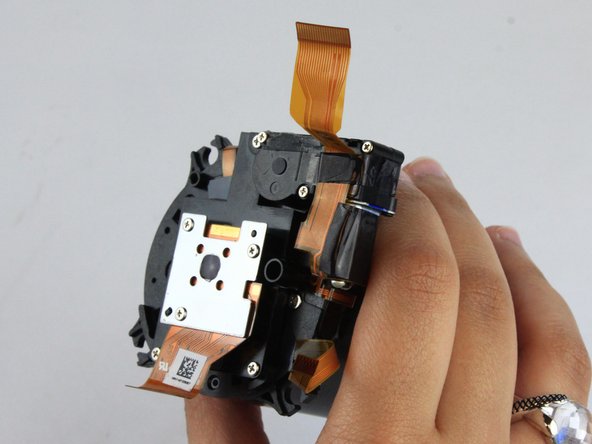

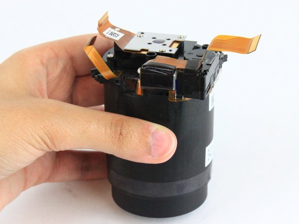

  15. Nikon Coolpix L330 Lens Barrel Assembly Replacement: crwdns2935265:015crwdnd2935265:01crwdnd2935265:01crwdne2935265:0
    • If the camera has grinding gears which lead to inefficient lens extension, this additional procedure will replace them.
    • Remove the three 1.25x4.75mm screws using a PH000 screw head.

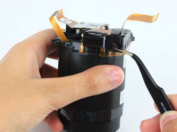

  16. Nikon Coolpix L330 Lens Barrel Assembly Replacement: crwdns2935265:016crwdnd2935265:01crwdnd2935265:03crwdne2935265:0 Nikon Coolpix L330 Lens Barrel Assembly Replacement: crwdns2935265:016crwdnd2935265:02crwdnd2935265:03crwdne2935265:0 Nikon Coolpix L330 Lens Barrel Assembly Replacement: crwdns2935265:016crwdnd2935265:03crwdnd2935265:03crwdne2935265:0
    • Black tape covers the motor assembly.
    • Remove the tape using a pair of tweezers.

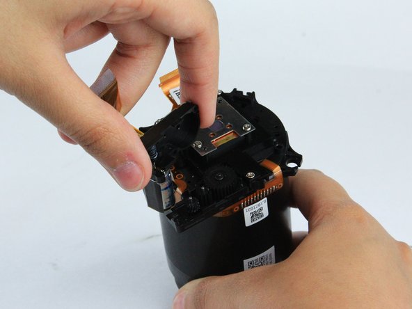

  17. Nikon Coolpix L330 Lens Barrel Assembly Replacement: crwdns2935265:017crwdnd2935265:01crwdnd2935265:03crwdne2935265:0 Nikon Coolpix L330 Lens Barrel Assembly Replacement: crwdns2935265:017crwdnd2935265:02crwdnd2935265:03crwdne2935265:0 Nikon Coolpix L330 Lens Barrel Assembly Replacement: crwdns2935265:017crwdnd2935265:03crwdnd2935265:03crwdne2935265:0
    • Lift the top part of the gear housing up and away from the main housing.
    • Check the gears to see if they are damaged and need replacing.
