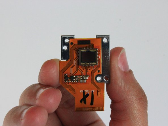

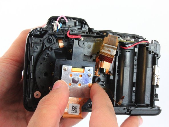

  13. Nikon Coolpix L330 Image Sensor Replacement, Image Sensor: crwdns2935265:013crwdnd2935265:01crwdnd2935265:02crwdne2935265:0 Nikon Coolpix L330 Image Sensor Replacement, Image Sensor: crwdns2935265:013crwdnd2935265:02crwdnd2935265:02crwdne2935265:0
    • Remove the three 1.5x2.5mm screws using a PH000 screw head.
  14. Nikon Coolpix L330 Image Sensor Replacement: crwdns2935265:014crwdnd2935265:01crwdnd2935265:02crwdne2935265:0 Nikon Coolpix L330 Image Sensor Replacement: crwdns2935265:014crwdnd2935265:02crwdnd2935265:02crwdne2935265:0
    • Remove the three 1.5x1.75mm screws holding the lens in place using a PH000 screw head.
    • Lift the image sensor up and out of the bracket.
