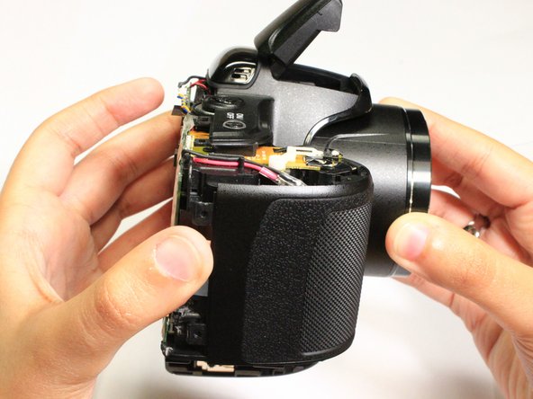

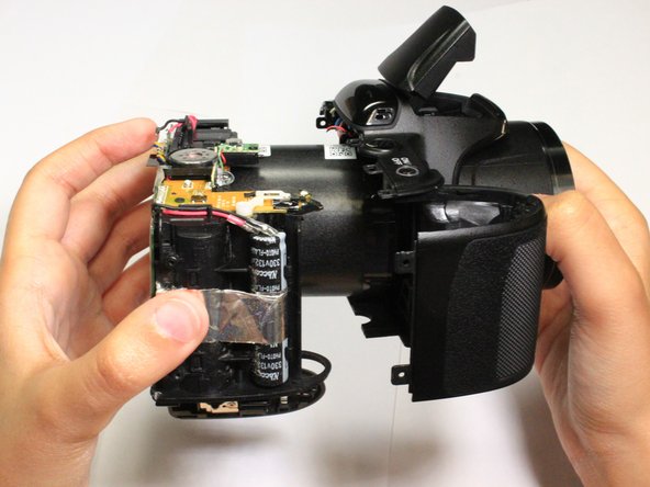

  7. Nikon Coolpix L330 Front Housing Replacement: crwdns2935265:07crwdnd2935265:01crwdnd2935265:03crwdne2935265:0 Nikon Coolpix L330 Front Housing Replacement: crwdns2935265:07crwdnd2935265:02crwdnd2935265:03crwdne2935265:0 Nikon Coolpix L330 Front Housing Replacement: crwdns2935265:07crwdnd2935265:03crwdnd2935265:03crwdne2935265:0
    • Position the fingers of one hand on the inner frame and the other hand around the lens barrel.
    • Pull the front housing away from the inner frame.
