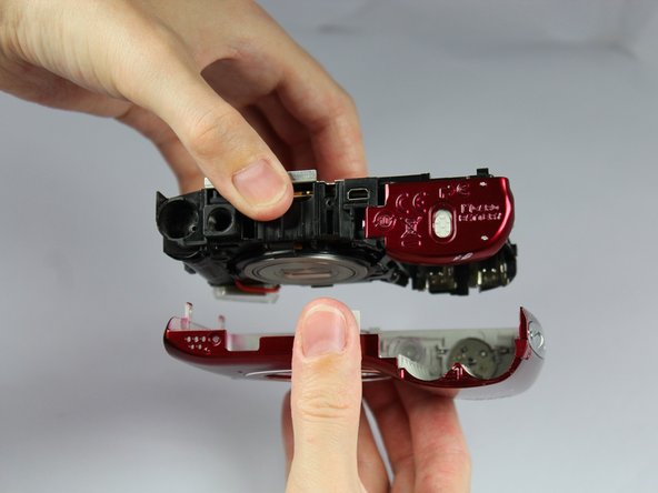

  14. Nikon Coolpix L26 Camera Front Cover Replacement: crwdns2935265:014crwdnd2935265:01crwdnd2935265:03crwdne2935265:0 Nikon Coolpix L26 Camera Front Cover Replacement: crwdns2935265:014crwdnd2935265:02crwdnd2935265:03crwdne2935265:0 Nikon Coolpix L26 Camera Front Cover Replacement: crwdns2935265:014crwdnd2935265:03crwdnd2935265:03crwdne2935265:0
    • Hold the camera with the lens face down to prevent the plastic covers of the warning light and the flash bulb from falling out.
    • Take a firm hold of the black inner casing of the top and bottom of internal camera. With your other hand, take a hold of the red front case.
    • With slight force, pull the internal camera upwards and out of the front case.
