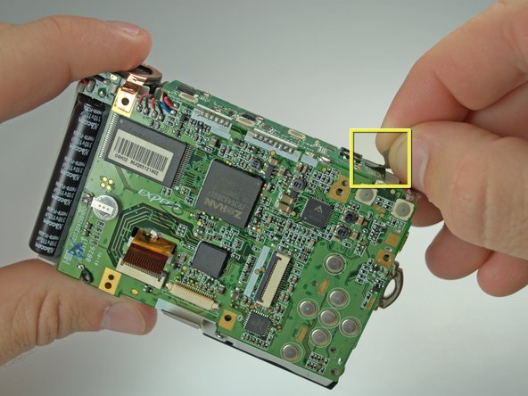

  16. Nikon Coolpix L18 Logic Board Replacement, Logic Board: crwdns2935265:016crwdnd2935265:01crwdnd2935265:02crwdne2935265:0 Nikon Coolpix L18 Logic Board Replacement, Logic Board: crwdns2935265:016crwdnd2935265:02crwdnd2935265:02crwdne2935265:0
    • Remove the tape on the top of the logic board.
  17. Nikon Coolpix L18 Logic Board Replacement: crwdns2935265:017crwdnd2935265:01crwdnd2935265:01crwdne2935265:0
    • Remove the 4 Phillips #00 screws holding the top of the logic board onto the camera frame.
  18. Nikon Coolpix L18 Logic Board Replacement: crwdns2935265:018crwdnd2935265:01crwdnd2935265:01crwdne2935265:0
    • Desolder the joint of the top and back of the logic board using a soldering iron and desoldering wick.
    • You will need to have soldering equipment to complete this step.
