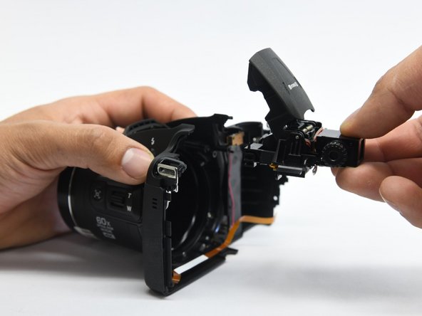

  23. Nikon Coolpix B700 Flash Unit Replacement, Flash Unit: crwdns2935265:023crwdnd2935265:01crwdnd2935265:01crwdne2935265:0
    • Using a Phillips screwdriver, remove the two 6 mm screws that hold the flash assembly.
  24. Nikon Coolpix B700 Flash Unit Replacement: crwdns2935265:024crwdnd2935265:01crwdnd2935265:02crwdne2935265:0 Nikon Coolpix B700 Flash Unit Replacement: crwdns2935265:024crwdnd2935265:02crwdnd2935265:02crwdne2935265:0
    • Now while pushing the flash button slide out the flash assembly from the housing.
    • The flash button could fall out when the assembly is removed.
    • During reassembly, insert the flash unit assembly first, then reconnect the flash button.
