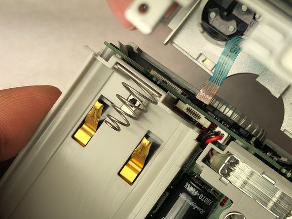

    • Flip the camera back so you can see the top.
    • Pull the ribbon cable out of the socket connecting to the motherboard by using your hands or tweezers.
    • Be careful not to puncture or rip the ribbon cable.

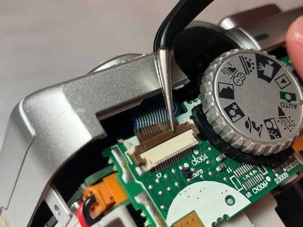

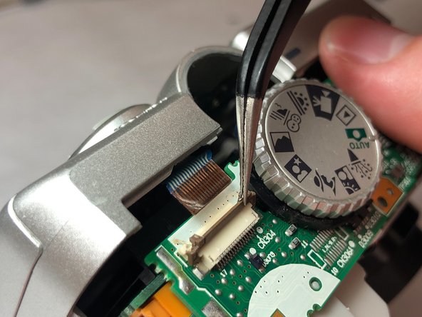

    • Look back to the top of the camera.
    • Flip up the tab that is exposed right by the dial using tweezers.
    • Release the ribbon to be able to separate the top part of the back of the camera.
    • Be careful not to rip the ribbon cable.

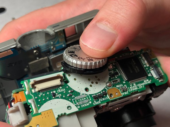

  9. Nikon Coolpix 775 Screen Replacement: crwdns2935265:09crwdnd2935265:01crwdnd2935265:03crwdne2935265:0 Nikon Coolpix 775 Screen Replacement: crwdns2935265:09crwdnd2935265:02crwdnd2935265:03crwdne2935265:0 Nikon Coolpix 775 Screen Replacement: crwdns2935265:09crwdnd2935265:03crwdnd2935265:03crwdne2935265:0
    • Push or slide the the top dial toward the backside of the camera to unclip from the motherboard.

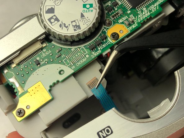

  11. Nikon Coolpix 775 Screen Replacement: crwdns2935265:011crwdnd2935265:01crwdnd2935265:03crwdne2935265:0 Nikon Coolpix 775 Screen Replacement: crwdns2935265:011crwdnd2935265:02crwdnd2935265:03crwdne2935265:0 Nikon Coolpix 775 Screen Replacement: crwdns2935265:011crwdnd2935265:03crwdnd2935265:03crwdne2935265:0
    • Pull the ribbon connected to the dial off the motherboard.
