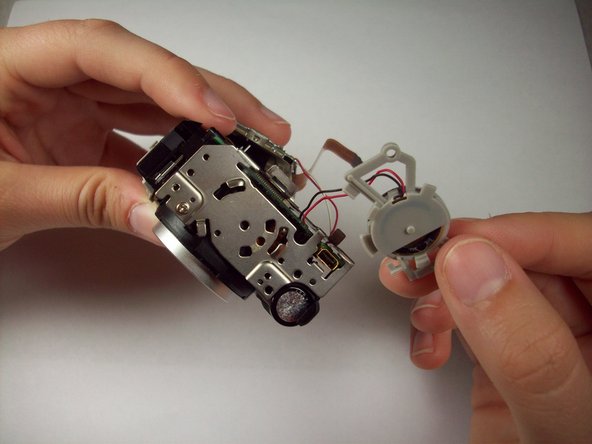

    • Turning the camera to the left and tilting it up, look at the left end of the motherboard to locate the grey bracket.
    • Twist the grey bracket counter clockwise to remove it from the silver LCD bracket.
  9. Nikon Coolpix 4600 Motherboard Replacement: crwdns2935265:09crwdnd2935265:01crwdnd2935265:02crwdne2935265:0 Nikon Coolpix 4600 Motherboard Replacement: crwdns2935265:09crwdnd2935265:02crwdnd2935265:02crwdne2935265:0
    • Using a Phillips 00 screwdriver, remove the 4.25 mm screw on bottom left edge of the LCD bracket.
    • Lift off the LCD bracket and slip the grey bracket through the LCD bracket. The LCD bracket should now be completely removed.
