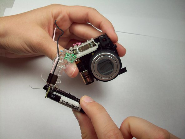

  11. Nikon Coolpix 4600 Lens and Flash Assembly Replacement, Lens and Flash Assembly: crwdns2935265:011crwdnd2935265:01crwdnd2935265:02crwdne2935265:0 Nikon Coolpix 4600 Lens and Flash Assembly Replacement, Lens and Flash Assembly: crwdns2935265:011crwdnd2935265:02crwdnd2935265:02crwdne2935265:0
    • The flash and lens assembly should now be separate from the motherboard.
    • Locate the capacitor. It is the component that looks similar in size and shape to a AAA battery.
    • With the lens upright and facing you, gently lift the capacitor up and to the left to remove main flash assembly.
  12. Nikon Coolpix 4600 Lens and Flash Assembly Replacement: crwdns2935265:012crwdnd2935265:01crwdnd2935265:01crwdne2935265:0
    • Locate the 4.8 mm screw above the middle of lens on the front side and remove it.
    • The flash bulb can now be lifted off the lens assembly.
  13. Nikon Coolpix 4600 Lens and Flash Assembly Replacement: crwdns2935265:013crwdnd2935265:01crwdnd2935265:01crwdne2935265:0
    • The lens assembly is now separated from all other components.
    • Follow the steps in reverse order to re-install new lens.
