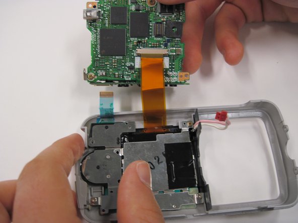

    3. Nikon Coolpix 3500 Lens Replacement: crwdns2935265:010crwdnd2935265:01crwdnd2935265:02crwdne2935265:0 Nikon Coolpix 3500 Lens Replacement: crwdns2935265:010crwdnd2935265:02crwdnd2935265:02crwdne2935265:0
      • Disconnect the blue wire connecting the motherboard to the LED screen.
      • Disconnect the orange wire using a spudger while pushing out horizontally.
      • Disconnect the red capped wire from the motherboard.
      • Lift the motherboard and lens (still connected) out of the back case.
