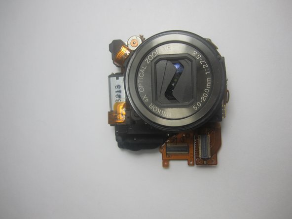

  15. Nikon CoolPix S600 Lens Assembly Replacement: crwdns2935265:015crwdnd2935265:01crwdnd2935265:02crwdne2935265:0 Nikon CoolPix S600 Lens Assembly Replacement: crwdns2935265:015crwdnd2935265:02crwdnd2935265:02crwdne2935265:0
    • Gently remove the two ribbons connecting the lens to the mother board.
  16. Nikon CoolPix S600 Lens Assembly Replacement: crwdns2935265:016crwdnd2935265:01crwdnd2935265:02crwdne2935265:0 Nikon CoolPix S600 Lens Assembly Replacement: crwdns2935265:016crwdnd2935265:02crwdnd2935265:02crwdne2935265:0
    • Gently separate the camera lens from the mother board.
