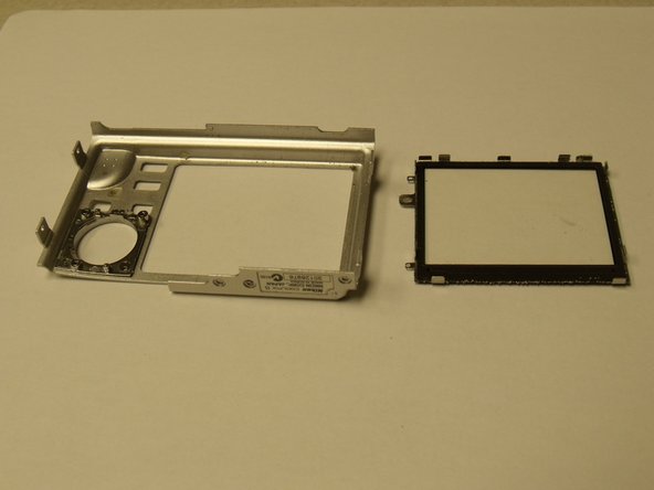

Nikon CoolPix S5 Plastic LCD Screen Cover Replacement
  1. Nikon CoolPix S5 Plastic LCD Screen Cover Replacement, Back Cover: crwdns2935265:01crwdnd2935265:01crwdnd2935265:01crwdne2935265:0
    • Remove the wristlet by untying the strap.
  2. Nikon CoolPix S5 Plastic LCD Screen Cover Replacement: crwdns2935265:02crwdnd2935265:01crwdnd2935265:01crwdne2935265:0
    • Open the SD/Battery cover.
  3. Nikon CoolPix S5 Plastic LCD Screen Cover Replacement: crwdns2935265:03crwdnd2935265:01crwdnd2935265:02crwdne2935265:0 Nikon CoolPix S5 Plastic LCD Screen Cover Replacement: crwdns2935265:03crwdnd2935265:02crwdnd2935265:02crwdne2935265:0
    • Remove the four screws adjacent to the SD/battery opening using a Phillips #00 screwdriver.
  4. Nikon CoolPix S5 Plastic LCD Screen Cover Replacement: crwdns2935265:04crwdnd2935265:01crwdnd2935265:02crwdne2935265:0 Nikon CoolPix S5 Plastic LCD Screen Cover Replacement: crwdns2935265:04crwdnd2935265:02crwdnd2935265:02crwdne2935265:0
    • Remove the side paneling of the camera by prying it off with your hands.
  5. Nikon CoolPix S5 Plastic LCD Screen Cover Replacement: crwdns2935265:05crwdnd2935265:01crwdnd2935265:02crwdne2935265:0 Nikon CoolPix S5 Plastic LCD Screen Cover Replacement: crwdns2935265:05crwdnd2935265:02crwdnd2935265:02crwdne2935265:0
    • Start on the wristlet side of the camera and use the #00 Phillips screwdriver to remove the two screws that hold the backplate in place.
    • Repeat the removal of the two screws on the other side of the camera.
  6. Nikon CoolPix S5 Plastic LCD Screen Cover Replacement: crwdns2935265:06crwdnd2935265:01crwdnd2935265:02crwdne2935265:0 Nikon CoolPix S5 Plastic LCD Screen Cover Replacement: crwdns2935265:06crwdnd2935265:02crwdnd2935265:02crwdne2935265:0
    • Separate the back faceplate from the rest of the camera.
  7. Nikon CoolPix S5 Plastic LCD Screen Cover Replacement, Plastic LCD Screen Cover: crwdns2935265:07crwdnd2935265:01crwdnd2935265:02crwdne2935265:0 Nikon CoolPix S5 Plastic LCD Screen Cover Replacement, Plastic LCD Screen Cover: crwdns2935265:07crwdnd2935265:02crwdnd2935265:02crwdne2935265:0
    • Press lightly on the outer surface of the plastic LCD screen cover in each corner.
    • The plastic LCD screen cover should pop out of the back plate.
