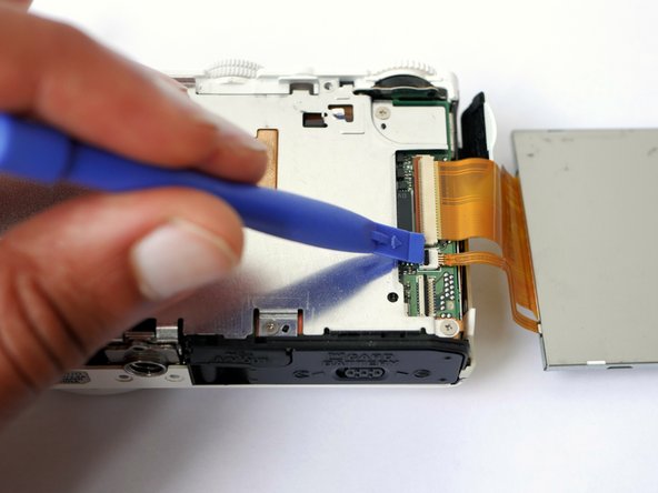

  3. Nikon CoolPix P310 Sensor Replacement or Cleaning, Removing the Screen: crwdns2935265:04crwdnd2935265:01crwdnd2935265:03crwdne2935265:0 Nikon CoolPix P310 Sensor Replacement or Cleaning, Removing the Screen: crwdns2935265:04crwdnd2935265:02crwdnd2935265:03crwdne2935265:0 Nikon CoolPix P310 Sensor Replacement or Cleaning, Removing the Screen: crwdns2935265:04crwdnd2935265:03crwdnd2935265:03crwdne2935265:0
    • Lift up the screen from the left side, to access its two ZIF connectors.
    • Open the small and the large ZIF connectors with a spudger.
    • The small connector is opened by lifting the black part.
    • The large connector is released thanks to the orange part. This longer connector needs to be opened carefully.
