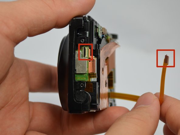

  11. Nikon COOLPIX S9500 Lens Replacement: crwdns2935265:011crwdnd2935265:01crwdnd2935265:02crwdne2935265:0 Nikon COOLPIX S9500 Lens Replacement: crwdns2935265:011crwdnd2935265:02crwdnd2935265:02crwdne2935265:0
    • Disconnect the ribbon cable from the left side of the camera.
    • You can do this by lifting the small black strip with your nail and rotating it 60 degrees on top of the connector. These connectors are fragile so don't use to much force. Now you can easily take the flat cable out (same for the other connectors).

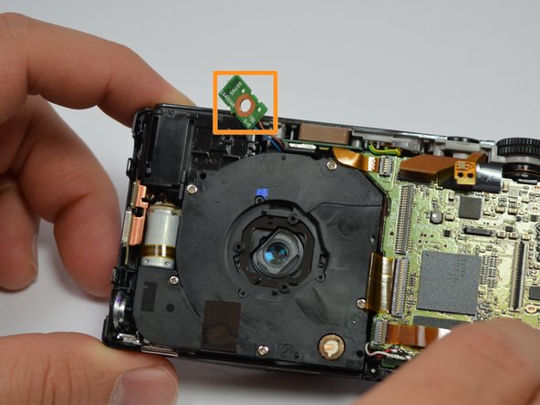

  15. Nikon COOLPIX S9500 Lens Replacement: crwdns2935265:015crwdnd2935265:01crwdnd2935265:01crwdne2935265:0
    • Detach the ribbon cable connecting the lens unit and circuit board.
  16. Nikon COOLPIX S9500 Lens Replacement: crwdns2935265:016crwdnd2935265:01crwdnd2935265:01crwdne2935265:0
    • The lens can now be removed from the camera.
