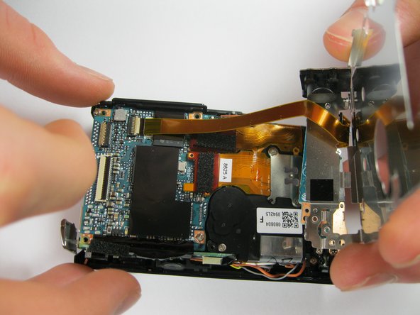

  15. Nikon COOLPIX S610c Front Casing Replacement: crwdns2935265:015crwdnd2935265:01crwdnd2935265:02crwdne2935265:0 Nikon COOLPIX S610c Front Casing Replacement: crwdns2935265:015crwdnd2935265:02crwdnd2935265:02crwdne2935265:0
    • Remove the final 4x3mm screw at the top of the camera near the lens.
  16. Nikon COOLPIX S610c Front Casing Replacement: crwdns2935265:016crwdnd2935265:01crwdnd2935265:02crwdne2935265:0 Nikon COOLPIX S610c Front Casing Replacement: crwdns2935265:016crwdnd2935265:02crwdnd2935265:02crwdne2935265:0
    • Pry the front casing away from the body of the camera.
    • Be careful not to damage the wires that attach the front panel to the motherboard.
    • Short the leads on the capacitor near the flash to avoid a nasty shock when separating the casing from the body.

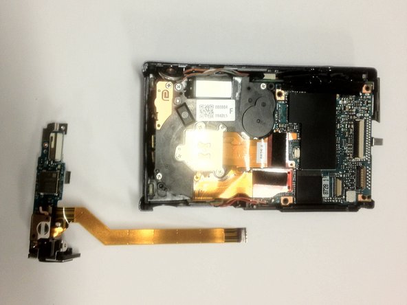

  17. Nikon COOLPIX S610c Front Casing Replacement: crwdns2935265:017crwdnd2935265:01crwdnd2935265:01crwdne2935265:0
    • Unscrew the three 3x2mm screws that attach the cables to the front casing.
