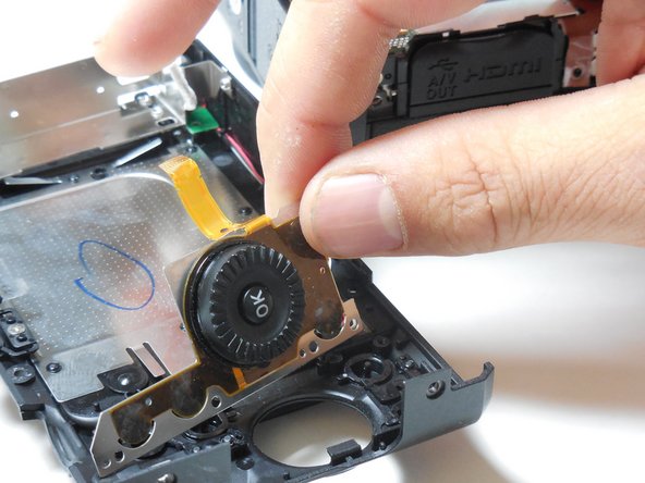

    1. Nikon COOLPIX P7700 Multi Selector Wheel Replacement, Multi Selector Wheel: crwdns2935265:08crwdnd2935265:01crwdnd2935265:01crwdne2935265:0
      • Remove the four 4.3 mm screws located on the far right metal plate. Use the Phillips #00 screwdriver.
    2. Nikon COOLPIX P7700 Multi Selector Wheel Replacement: crwdns2935265:09crwdnd2935265:01crwdnd2935265:02crwdne2935265:0 Nikon COOLPIX P7700 Multi Selector Wheel Replacement: crwdns2935265:09crwdnd2935265:02crwdnd2935265:02crwdne2935265:0
      • Remove and replace wheel.

Step 9: I believe that the multi-selector wheel component is soldered, 3 wires just visible in the photo for step 8. This will surely add to the time taken and difficulty.

See my comment above, for spray cleaning the wheel without any replacement. Unless your wheel is brokwn, you can try my suggestion. It works.
JY - crwdns2934203:0crwdne2934203:0 crwdns2950251:0crwdne2950251:0
Please see my comment on the "general" method of fixing the wheel (using fast-drying contact cleaner) without ANY component replacement or unscrewing. It works really well but you may have to do it 1-3 times until all the dirt inside the wheel mechanism is removed. I have managed to restore my P7700 (after "fixing" the erratic Control Wheel and the dis-obedient Play button). Since then I have used the same method to fix the control wheel on my Samsung EX-1 camera (the control wheel was replaced twice by Samsung but the problem came back after a year or so). The root cause is probably a weak control wheel design (maybe tiny metal springs rotating over a base-plate with printed circuits). Now I know how to save money and trouble (for any compact camera with a similar control wheel design).
